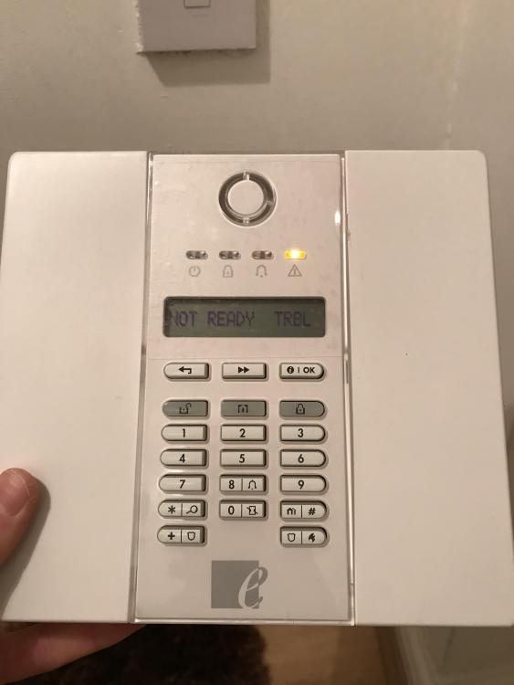

Anthony181 Posted October 10, 2017 Posted October 10, 2017 Can someone please tell me what company and model this alarm is? It’s beeping like an alarm clock every couple of minutes and does so even when the code is inputted. Unscrewed it thinking the batteries need changing however they are wrapped in green plastic branded GP NIMH Battery so didn’t want to touch them. Need to download the instructions. Thanks Quote
MrHappy Posted October 11, 2017 Posted October 11, 2017 1 hour ago, aissecur said: its a visonic yes, "Power Max Express" or something Quote Mr Veritas God
sixwheeledbeast Posted October 11, 2017 Posted October 11, 2017 Powermax Express. You are likely to have a sensor with a flat battery, if you keep pressing I/OK button it will tell you the faults. Quote
