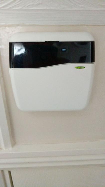

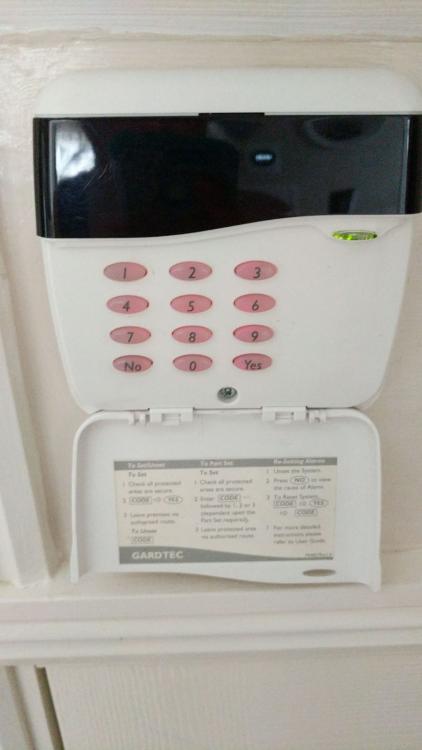

FuzzyDunlop Posted October 19, 2017 Posted October 19, 2017 Hi, thanks in advance for any help you can offer I recently moved into my new house, with a working Gardtec alarm system. Last week the alarm went off during a powercut and we typed in the code to stop it. The screen went blank and now doesn't work at all. It looks like it still has power, because the green light is on (see photos). I'm not sure what Gardtec we have but I hope the panel photos help identify it. Any ideas on how to fix or do I need to replace? Quote
aissecur Posted October 19, 2017 Posted October 19, 2017 The keypad is a gardtec contour keypad (LED) The panel could be a 500 series (501 / 593) hard to tell without seeing the endstation It sounds like you have an issue with the control panel back up battery and this may of caused an NVM issue (loosing the system codes / parameters) When was the last time the system was serviced? Quote
