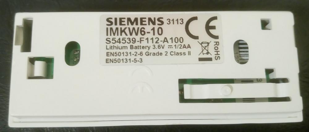

xpertalarms Posted October 26, 2017 Posted October 26, 2017 Hi all, Taking over an SPC at the moment and it has one wireless zone on it, the zone status shows as 'disconnected' about a minute after learning it on, the customer said that they had the same issue before. Battery is ok and signal is fine, any ideas? Ta Quote

datadiffusion Posted October 26, 2017 Posted October 26, 2017 Sounds as if it's going into sleep mode - it's 2 way. Quote So, I've decided to take my work back underground.... to stop it falling into the wrong hands

jnealon Posted October 27, 2017 Posted October 27, 2017 The only time I see the SPC/Signet wireless devices go discon is either when the tamper is open or the battery is removed. Apart from that I'd say faulty sensor 1 Quote www.realsecurity.ie
