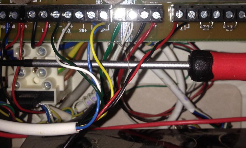

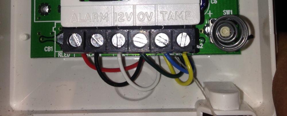

Solomon Posted November 20, 2017 Posted November 20, 2017 We've had a veritas 8 system for some time and there have been no issues. It is being used in our outhouse/office and uses just a single zone. Recently we have been remodelling the office and the motion detector ended up being inside a toilet cubicle, so I decided to move the sensor. The sensor is now wired, as far as I can tell, in exactly the same configuration as before only using a different length of 6-core cable. Now, when trying to set the alarm, I get a continuous series of single beeps whilst the zone 1 LED is lit red - I assume to show an error with the zone 1 detector, reinforced by the single beeps (instead of multiple beeps). I have tried shutting off the power and disconnecting the battery to try to reset it to no avail. A red light is showing in the detector, albeit quite dimly. Could anyone help me debug it please? Quote

james.wilson Posted November 20, 2017 Posted November 20, 2017 I cant see the panel but is green white reversed? Quote securitywarehouse Security Supplies from Security Warehouse Trade Members please contact us for your TSI vetted trade discount.
sixwheeledbeast Posted November 20, 2017 Posted November 20, 2017 Wiring looks fine from what I can tell. How many times is the system beeping? Likely to be a tamper issue I agree. Or maybe a blown fuse would make sense if the PIR is active all the time. Quote

Solomon Posted November 20, 2017 Author Posted November 20, 2017 1 hour ago, james.wilson said: I cant see the panel but is green white reversed? As far as I know I completely duplicated the wiring from the original installation. do note that the green and black are almost impossible to differentiate in the photos - it's very dark green. Quote

al-yeti Posted November 20, 2017 Posted November 20, 2017 1 hour ago, james.wilson said: I cant see the panel but is green white reversed? Lol didn't spot that , could be cos they normally have negs together in the panel end 26 minutes ago, Solomon said: As far as I know I completely duplicated the wiring from the original installation. do note that the green and black are almost impossible to differentiate in the photos - it's very dark green. He means you sure it's negative to negative and positive to positive Quote
Solomon Posted November 20, 2017 Author Posted November 20, 2017 24 minutes ago, al-yeti said: Lol didn't spot that , could be cos they normally have negs together in the panel end He means you sure it's negative to negative and positive to positive No I'm not sure I will swap and see what happens. Quote
sixwheeledbeast Posted November 20, 2017 Posted November 20, 2017 Green and Black wires are wrong way round in the sensor if you look very closely. It will be one beep for zone 1 active. Quote
