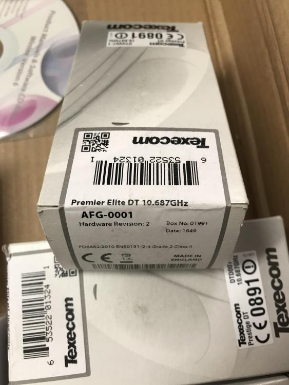

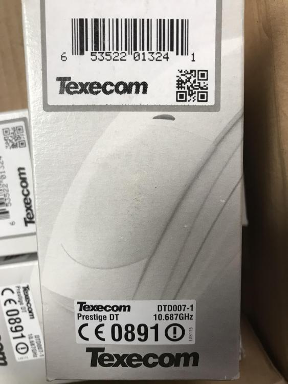

Sorry, I mean a Dual Tech sensor is installed the garage. The model of Sensor is ‘Texecom Premier DT’
