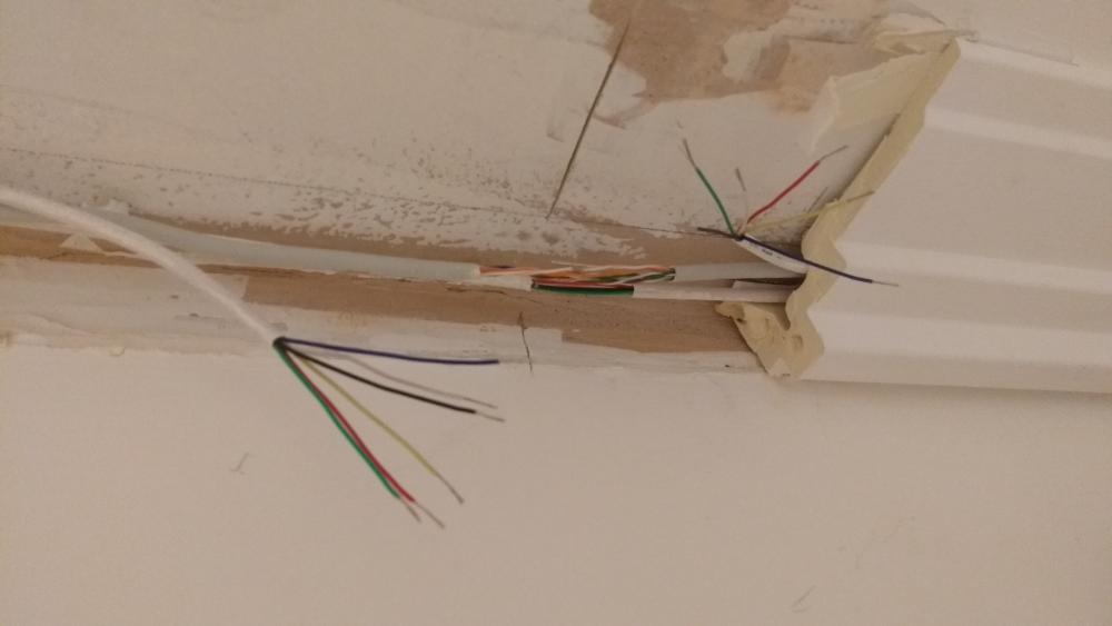

MarkJohnson Posted January 15, 2018 Posted January 15, 2018 Morning gents! Based on a lot of background reading I did on this forum, a Texecom Premier Elite was fitted about 6 months ago and a great alarm it is too! Problem I have now is that when cutting off some cornice at the top of the ceiling, we completely forgot that the telephone and alarm cable was run through there. As such, we cut through the damn thing. I'd like to patch this up as it leads to a key patio door sensor. The bigger issue is that the cable is crappy CCA (copper clad alu) as opposed to quality cable. Don't ask how or why that was used. So I guess question is how do I connect this crappy cable back up again? Can't solder it. I can only think of something like this (a pack of ten is a couple quid and they are tiny): https://www.tlc-direct.co.uk/Products/WA415.html Also, as the system is 'live' and I don't wish to short anything, how would I power it down temporarily? Quote
MarkJohnson Posted January 15, 2018 Author Posted January 15, 2018 (edited) Just to clear up on the above, my choices (unless you guys have a better suggestion) at the moment to fix this mess are: (1)Lever splicing connector: https://www.tlc-direct.co.uk/Products/WA415.html (2) Some crimps: https://www.tlc-direct.co.uk/Main_Index/Cable_Accessories_Index/Crimp_Lugs_and_Tools/index.html (3) A small, 2a connector strip (two-way): https://www.tlc-direct.co.uk/Products/TLCON2.html Edited January 15, 2018 by MarkJohnson Quote
