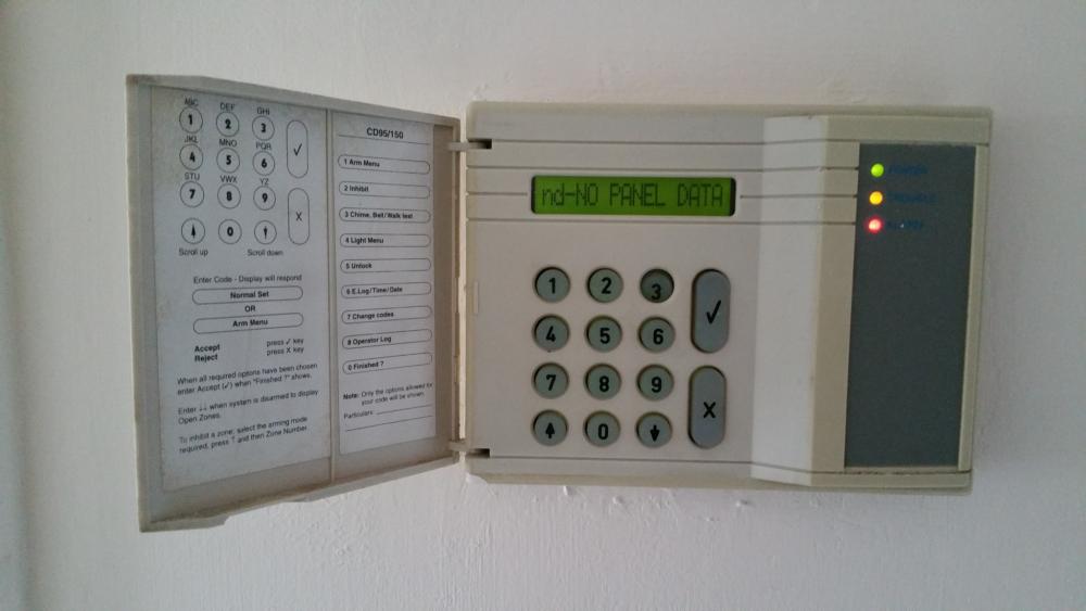

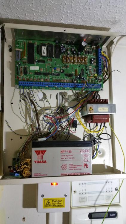

LeepyLee Posted February 9, 2018 Posted February 9, 2018 Hi, Just wondering if anyone can identify this alarm system please? The panel is showing "nd-NO PANEL DATA" and all three LEDs are illuminated. I know the battery is no good and needs changing. All fuses seem to be good (with a meter across them). The codes are unknown, so will need a factory reset I guess. Thanks all! Quote
norman Posted February 9, 2018 Posted February 9, 2018 Hi, it's an Aritech CD 95 with a solitaire light controller and a SD1+ speech dialer underneath... 1 Quote Nothing is foolproof to a sufficiently talented fool.
LeepyLee Posted February 9, 2018 Author Posted February 9, 2018 That's great! Thanks for the quick reply. Any thoughts on what the problem may be please? Quote

Nova-Security Posted February 10, 2018 Posted February 10, 2018 Check the cabling between the panel and keypad 47.48,49,50 Quote www.nova-security.co.uk www.nsiapproved.co.uk No PMs please unless i know you or you are using this board with your proper name.
Nova-Security Posted February 10, 2018 Posted February 10, 2018 Nd-No Panel Data - The control panel is receiving no more data from the panel Reboot it Quote www.nova-security.co.uk www.nsiapproved.co.uk No PMs please unless i know you or you are using this board with your proper name.

Nova-Security Posted February 11, 2018 Posted February 11, 2018 Defaulting it wont clear the data fault 1 Quote www.nova-security.co.uk www.nsiapproved.co.uk No PMs please unless i know you or you are using this board with your proper name.
