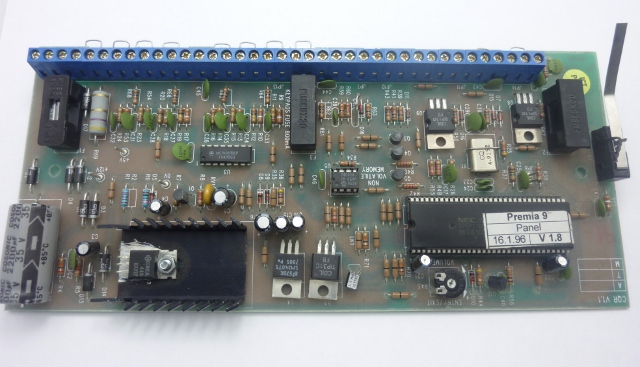

By the time you pay for a service and speech dialler it wouldn't be much more to stick in a euro with the app functionality and at least have some confidence in it, your old panel is on borrowed time the electrolytic caps will be dried out, the prom and nvm will be at the end of their useful life and if you havent had it serviced in so long the charging circuit will be shagged. Things wear out, especially when neglected but even when nurtured they have a finite life and replacing the worn parts before they let you down when you need them most is preventative maintenance.
Quoted for agreement

Pad shows St - basic clean and reset needed. I wonder if there are fuses in it that should be replaced as a matter of course?
Could anybody tell em if the fuses should be replaced as a matter of course - since even if they are 'working' - they have been there a while.
And then service - to the point that all the measurements be retaken and a full walk through test be done.
