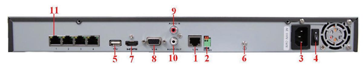

so the below 11 is the network port for connecting Network Connections for cameras and the 1 is for Network connection for internet, as below i need to buy NVR.
  1.  Network connection for internet
  2. PTZ Connector
  3. Mains Power Connector
  4. On/ Off Switch
  5. USB Connector
  6. Ground Connector
  7. HDMI Connector
  8. VGA Connector
  9. Audio In
  10. Audio Out
  11. Network Connections for cameras
Yes that's one way of doing it , but if your sticking up three or four cameras get an 8way NVR less hassle in future
1 hour ago, CARETAKER46 said:
I might get 8 way or 16way and does this NVR has hard drive to save your cctv recording or it saves on the server.
Most have hard drives or you purchase separate
Not sure about server connection, some nvrs have external storage connections etc don't think this version does unless hik has a way for you to do it which wouldn't surprise me they do all sorts
But that's over the top for what you want really
