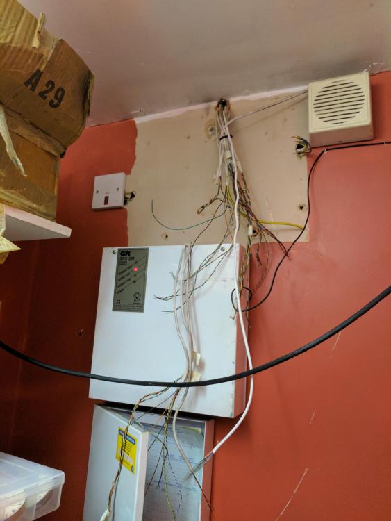

In January 2017, our retail premises were broken into via a 24 guard door (which should have notified the Key holder) and then the intruders walked passed a couple of PIRs (which should have called the Police). None of these two notifications took place. The burglars then tore the Galaxy 18 off the wall to stop it communicating via GSM. This allowed the intruders to get away with over £200k of stock somehow with no one knowing. We only found out the following morning that there was a break-in and notified the Police.
Although the NVR was taken, the Galaxy panel was left behind. So, I'm hoping that there is someone out there that has the tools or software to read the ROM on the panel to find out actually what happened. I've attached an image of the PCB if that helps at all. I'm able to deliver the panel anywhere within the Midlands (or further if need be) and I'm happy to pay for anyone's time and service.

If the panel has been powered down and stored since the break in then the system log would be intact and could be interrogated with master user or engineer access.
This is something you need to liaise with the original maintainer and insurance about before proceeding any further.
From experience of this type of incident the log will be full of events as the system won't have been disarmed.

as long as it hasnt crashed engineer menu 44 will show the last set and activation entries id send it back to the maintainer or honeywell personally as any tom retrieving the data could be dragged into court as an expert witness

A galaxy 18 does not have a NVM to store the log, it retains it by a battery on board which if in good condition might hold the programming and log for a month or two as we have found, but galaxy state 48hrs retention and if the battery is knacked as soon as mains and battery backup have been removed the information has
 gone.

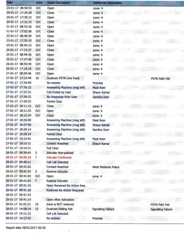

If it was communicating via GSM to an approved ARC did the monitoring station get a close the night before the incident ?

If insurance company had taken the panel, it would have been within a couple of days and they might have the log along with ARC logs.
Incident Jan 17 its a bit late to try and do anything.
