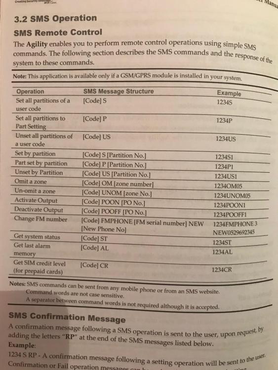

Hello, I’m new to the site, installed my Agility system about 4 or 5 years ago and just recently got broken into, anti snap locks now fitted!!!
i have just added the gsm module so I can be texted when the alarm goes off but i can’t find where I set which number it should call (my number), it’s all working as I can text the sim and set/unset the alarm but that’s not really why I got it.
I have a feeling it under the follow me menu but when I try going into the menu it displays “Not Available”, anyone got any suggestions before I contact Risco tech help and make myself look a fool?

Got it sorted, it’s in the user Manual rather than the engineer Manual, just in case anyone else has the problem this is how it’s done:
 You send the following text to the sim in your alarm.
code FMPHONE n NEW number
code is the user code for arming alarm.
n is the follow me number, I used 1.
number is the number you want texting.

That's great to know - I just installed a GSM module too. Waiting for my giffgaff sim to arrive. What SIM do you use?
Also can you add multiple Follow Mes for the text e.g:
1234 FMPHONE 1 NEW 07123456789 (FOR ME THE GRAND MASTER)
4321 FMPHONE 2 NEW 07912345678 (FOR USER 2 - THE WIFES PIN)

Yes you can, I used m2m (machine 2 machine) they ensure you sim will never expire
