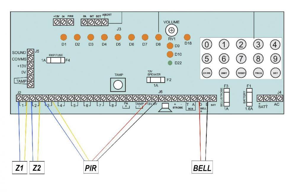

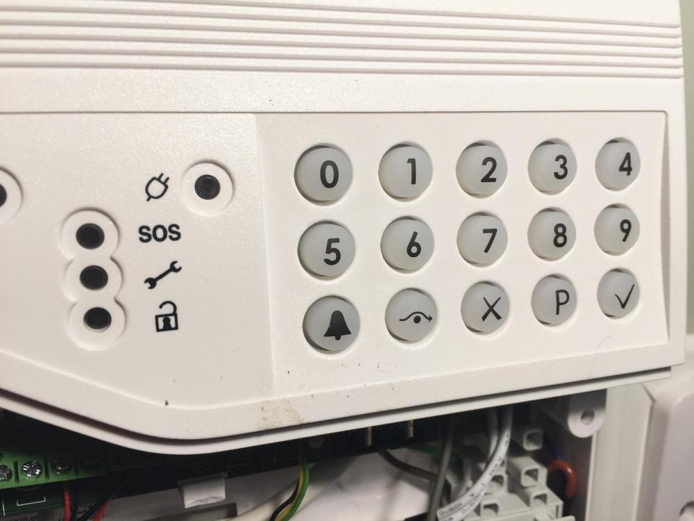

Jack2000 Posted October 2, 2018 Posted October 2, 2018 Newbie on here - am not an engineer, but have some experience in wiring, have installed a few systems successfully, though straightforward and simple ones. Jut fitted a new Optima compact gen4 (LED and no external keypad) and as expected - in alarm state as soon as its powered up, so logic(?) i enter the default code - no change, try the engineers code - nothing - I am stuck with it. no faults showing, not even tamper on cover, but just the red power LCD, as though armed/set I believe. Have done both reset to factory settings and reset user codes procedures (link from SET to PA or TAMP respectively) - no change there. set up 'as it arrived' apart from my 3 zones connected, maybe I've got a link in that shouldn't be or vice versa? grateful for any ideas anyone? Quote

Jack2000 Posted October 2, 2018 Author Posted October 2, 2018 (edited) to Al- yeti - no - except for a slight 'beep' when the 3 of the default 0123 code is pressed. Mr happy - Ah - not sure - so on the as delivered panel (per diagram) - PA - TAMP and SCB are still there - plus TAMP on the left hand site connectors Edited October 2, 2018 by Jack2000 Quote
al-yeti Posted October 2, 2018 Posted October 2, 2018 42 minutes ago, Jack2000 said: to Al- yeti - no - except for a slight 'beep' when the 3 of the default 0123 code is pressed. Mr happy - Ah - not sure - so on the as delivered panel (per diagram) - PA - TAMP and SCB are still there - plus TAMP on the left hand site connectors Can you take a picture with the top cover off? 1 minute ago, al-yeti said: Can you take a picture with the top cover off? Maybe that you have damage the ribbon cable or its not in properly , power down and insert correctly and try again Quote
Jack2000 Posted October 2, 2018 Author Posted October 2, 2018 no need for a picture Al-yeti, you are indeed a star - it was the ribbon cable - pushed the connector home and bingo. Can't thank you enough, get down the boozer - I'll buy you a pint. what a bleeding relief! Quote
