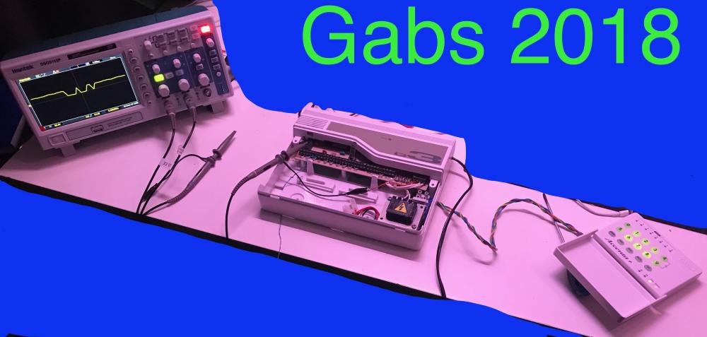

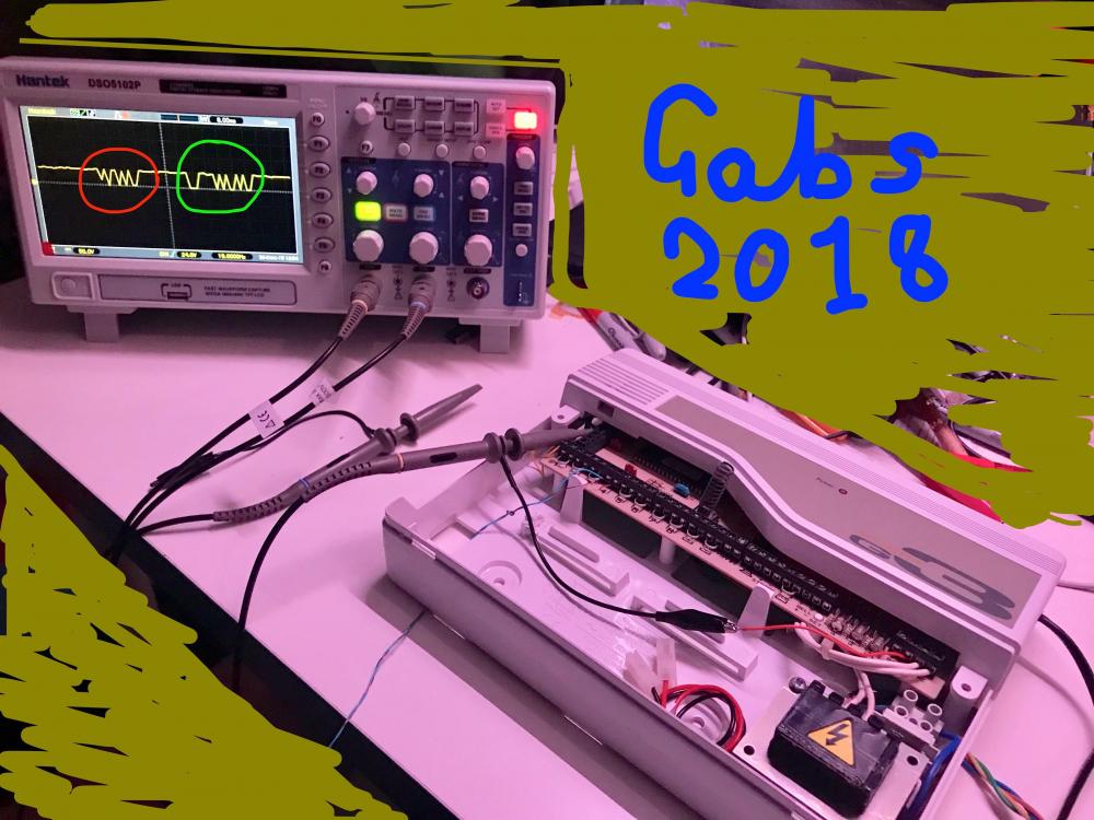

Gabs Posted December 27, 2018 Share Posted December 27, 2018 ANY HELP IS GREATLY APPRECIATED Would anyone be able to help me in finding out how a keypad talks to the main panel, I have an oscilloscope asd I have connected it to the 'Comms' wire, when the Accenta keypad is connected to the panel. This wire is at a constant 5 volts, with dips in this voltage when a button is pressed, or the panel needs to send the keypad information. This first image shows the data line between the panel and keypad when 1 has been pressed, these dips in the 5 volt signal were created by the keypad, for the panel to recognise. The above image shows what happens when the 'PROG' key is pressed. The highlighted in red waveform is the keypad sending the Prog signal to the panel, the one in green is the panel responding to the keypad telling it to light up all LEDs. What I do not understand is how the keypad can create a dip in the 5v line if the panel is constantly giving out 5v, same with the panel, how can it then create a drop in the voltage in the data line, if the keypad is constantly giving out 5v. The only way I thought it could be done was the panel shorts out the keypads data line, and the same with the keypad, it shorts out the 5v of the keypad to create 0v in the 2 way data line. Just wondering if this is correct? If anyone knows. I have tried the sound line, however it doesn't carry any data, just 'beeps' and alarm tones. Link to comment https://www.thesecurityinstaller.co.uk/community/topic/42579-accenta-comms-help-needed/ Share on other sites More sharing options...
sixwheeledbeast Posted December 27, 2018 Share Posted December 27, 2018 Having never attacked an Accenta with a scope before I am just theorising, however... On a Accenta you have one signal line for data transmission therefore the transmission is serial. As you say there are no separate Clock and Data lines to avoid data collision but what's to say a single non-zero return (NRZ) signal cannot be two way? You could still transfer signals asymmetrically, maybe down to encoding for example, you could have a stop (handover) bit. The last bit on the scope images seems similar so this maybe the handshake bit for the reply or even the actual handover of the supply. Both will need the ability to drive 5V signals to each other, although I would imagine the keypad will supply it most of the time. That way if the voltage is missing (hence using NRZ) for a period of time the keypad could be declined offline and tampered. If you think about it these non-LCD basic alarm keypads are fairly dumb, they sit and wait for input so in most cases the messages to be sent towards the panel are call and response (the response changing/updating the display with data from panel). The only time the panel would need to call the keypad into action (send data the keypads way) would be in an alarm situation, hmm I wonder what that sound wire could also be used for... Link to comment https://www.thesecurityinstaller.co.uk/community/topic/42579-accenta-comms-help-needed/#findComment-481538 Share on other sites More sharing options...

Gabs Posted December 27, 2018 Author Share Posted December 27, 2018 1 hour ago, sixwheeledbeast said: Having never attacked an Accenta with a scope before I am just theorising, however... On a Accenta you have one signal line for data transmission therefore the transmission is serial. As you say there are no separate Clock and Data lines to avoid data collision but what's to say a single non-zero return (NRZ) signal cannot be two way? You could still transfer signals asymmetrically, maybe down to encoding for example, you could have a stop (handover) bit. The last bit on the scope images seems similar so this maybe the handshake bit for the reply or even the actual handover of the supply. Both will need the ability to drive 5V signals to each other, although I would imagine the keypad will supply it most of the time. That way if the voltage is missing (hence using NRZ) for a period of time the keypad could be declined offline and tampered. If you think about it these non-LCD basic alarm keypads are fairly dumb, they sit and wait for input so in most cases the messages to be sent towards the panel are call and response (the response changing/updating the display with data from panel). The only time the panel would need to call the keypad into action (send data the keypads way) would be in an alarm situation, hmm I wonder what that sound wire could also be used for... Wow, thanks for the reply, think I understand it I understand that, but still am unsure how the keypad can drop the 5v that the panel is sending it, when a button is pushed. I would have thought that the Comms was always at 0v, and would only become active with 5v when a button is pushed, the Accenta has a different Tamper loop, with the comms disconnected, but everything else left in place, none of the keypad buttons work, as it is only this line the signal is send down. I have an early Accenta LCD keypad, and it works with his panel, using exactly the same drops in voltage, so it can recognise them and then displays vague messages on the screen, not as good as the G4 one. If I was designing an alarm, I'd have made it like this, If one or 2 were pressed, then the button number would correspond with the number of 5V Square waves are sent. Can you think of any reason, the ADE didn't do it like this? Or have any alarm manufacturers done it like this? Thanks, Gabs Link to comment https://www.thesecurityinstaller.co.uk/community/topic/42579-accenta-comms-help-needed/#findComment-481540 Share on other sites More sharing options...

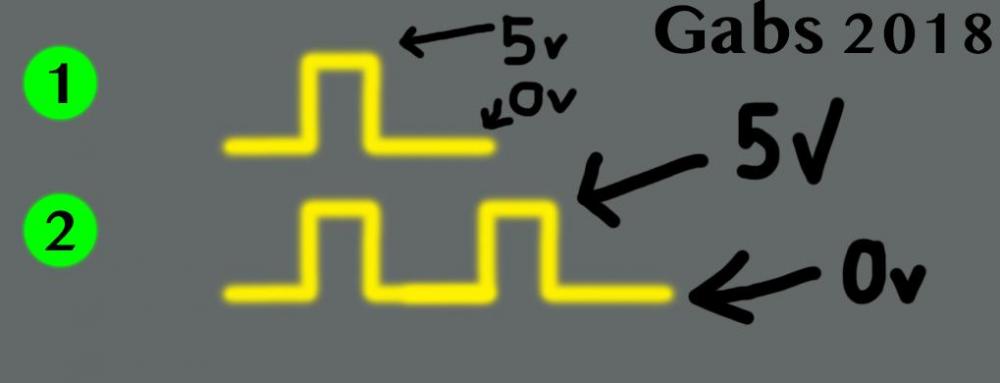

sixwheeledbeast Posted December 27, 2018 Share Posted December 27, 2018 Ah yes you are correct about the tamper loop, although the theory is still correct. Have a look into NRZ serial transmission for other benefits of having the line high all the time. Also think about what could happen if there was an intermittent short on the multi cored cable for example. Transmitting decimal numbers via a type of pulsing binary is very inefficient. Your too young to remember how long it took to dial 999 on a pulse phone... You can send a hex value in a nibble, for example this would cover all 15 keys no problem, but imagine an easier ways using rows and columns which keypads generally are. As an example, divide your keypad into col (1-3) and row (1-5). that's 3x5 each axis (We will start counting at 1 here not 0). Send binary X, binary Y and a check and/or stop bit, all can be done with binary in a bytes worth of data. Key 0 001 001 1 0 Key 1 001 010 1 0 ... key 7 010 011 0 1 ... Key Prog 011 100 0 1 Key Set 011 101 1 0 All the keys would be sent in the same amount of time as sending an 8 via pulse. Using BCD you could likely make that smaller again, the lesser amount of bits needed to transmit to get the message over the quicker the communication. Link to comment https://www.thesecurityinstaller.co.uk/community/topic/42579-accenta-comms-help-needed/#findComment-481541 Share on other sites More sharing options...
