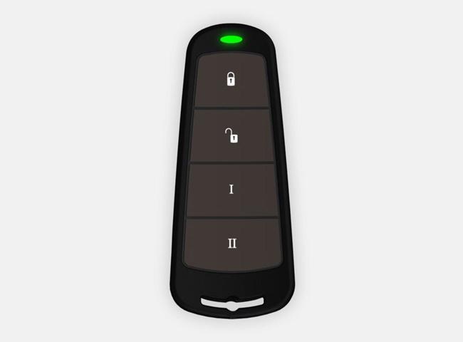

Pyronix KEYFOB-WE 4 button Wireless Setting Fob

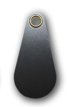

Pyronix EUR-ETAG
Pyronix EUR-ETAG
