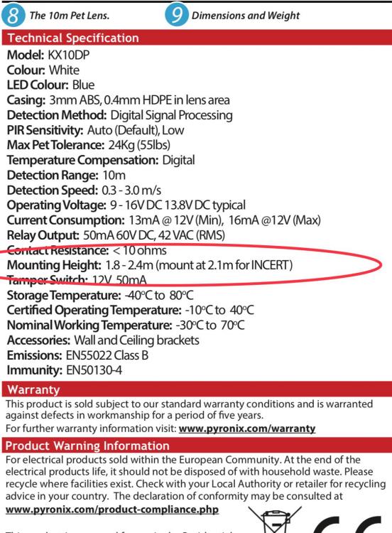

9 hours ago, Amps said:
They need to be installed at 2.1 meters rather than 2.4 meters for the standard pir’s.
Yeah I noticed they worked better lower down but that's still no good on a domestic. They need to be near the ceiling else it looks poor in my opinion
Yeah I agree. Far from perfect.

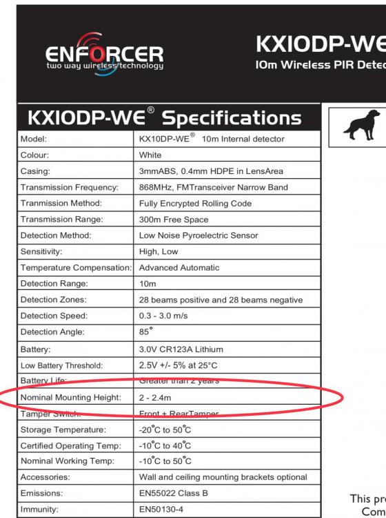

Stupid thing is for the wireless version there is no mention of the 2.1m height
