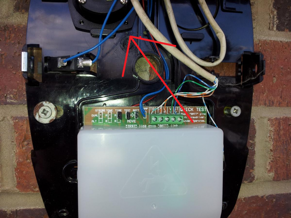

Mad Man Dyson Posted January 18, 2019 Posted January 18, 2019 This is the piezo that delivers the siren tone, driven from the pcb, have the cables and piezo been ripped out in an attempt to silence the unit?? 1 Quote

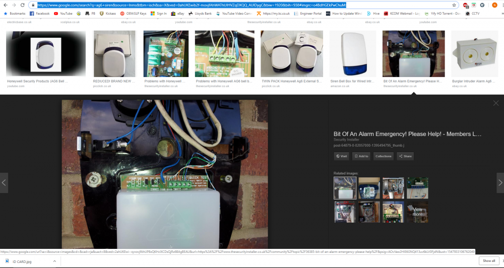

Mad Man Dyson Posted January 18, 2019 Posted January 18, 2019 (edited) Handy little image for you there matey Edited January 18, 2019 by Mad Man Dyson 1 Quote
sixwheeledbeast Posted January 18, 2019 Posted January 18, 2019 Wired in phone cable not great... Not only the Piezo wires but Test jumper on and battery jumper off also. 1 1 Quote
Mad Man Dyson Posted January 18, 2019 Posted January 18, 2019 On 18/01/2019 at 21:56, sixwheeledbeast said: Wired in phone cable not great... Not only the Piezo wires but Test jumper on and battery jumper off also. Expand Picture Is not mine haha, I would not embarass myself, picture stolen from google! 1 Quote

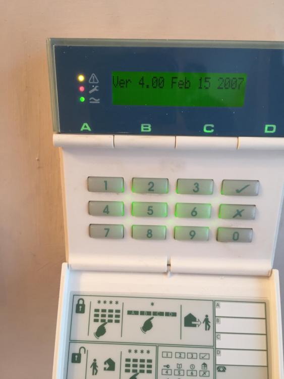

Carlos12 Posted January 19, 2019 Author Posted January 19, 2019 (edited) Wired this up, getting a fault on Zone 08? https://imgur.com/a/1ck4y5d Scroll down for bellbox wiring. Really stumped what the issue is? Any help is really appreciated, thanks. Edited January 19, 2019 by Carlos12 Quote
sixwheeledbeast Posted January 19, 2019 Posted January 19, 2019 Whats on Zone 8? It's likely unrelated to the bellbox being a Zone Quote
