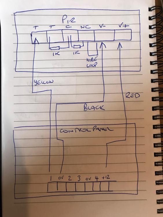

RevolvingSteve Posted January 19, 2019 Posted January 19, 2019 (edited) After some great advice on this thread: I now have the unit wired up, turned on, all faults cleared and the unit powered on with the time and date set, not much to others I'm sure but a minor milestone to me! :0) Finally got a day without work/kids/life steamrolling over any free time so going to try and get the configuration done today. En game is: 2 'Set' options (one for everything active when we are out if the house, one for downstairs when we are in bed) 3 Users created 3 Keyprox Tags assigned to the users Change passcodes for Standard 'User' and 'Engineer' users Ethernet module configured to access internet, DDNS setup, iOS App connected (Both Internally and Externally from the house) Is there a recommended flow of doing this or does it not matter? Any tips are gratefully received as always as the install manual is about 200 pages long! To add, is there a full menu map anywhere I can print off? Edited January 19, 2019 by RevolvingSteve Quote

RevolvingSteve Posted January 19, 2019 Author Posted January 19, 2019 (edited) 1 hour ago, GalaxyGuy said: Part entry. I am going to have to move 2 x PIR onto 1 zone (failed to take into account the final zone on its own door contact). TBH I almost put both upstairs PIR's onto 1 zone to start with so it was easier to omit/exclude them from the night arming, so I'm not bothered about now putting them onto 1 zone. How would I adjust the wiring on zone 11 & 12 given to compile them onto 11, I have the PIR's internally wired like the image below. Obviously replace '1' 0v '2' with 11 & 12! Edited January 19, 2019 by RevolvingSteve Quote
