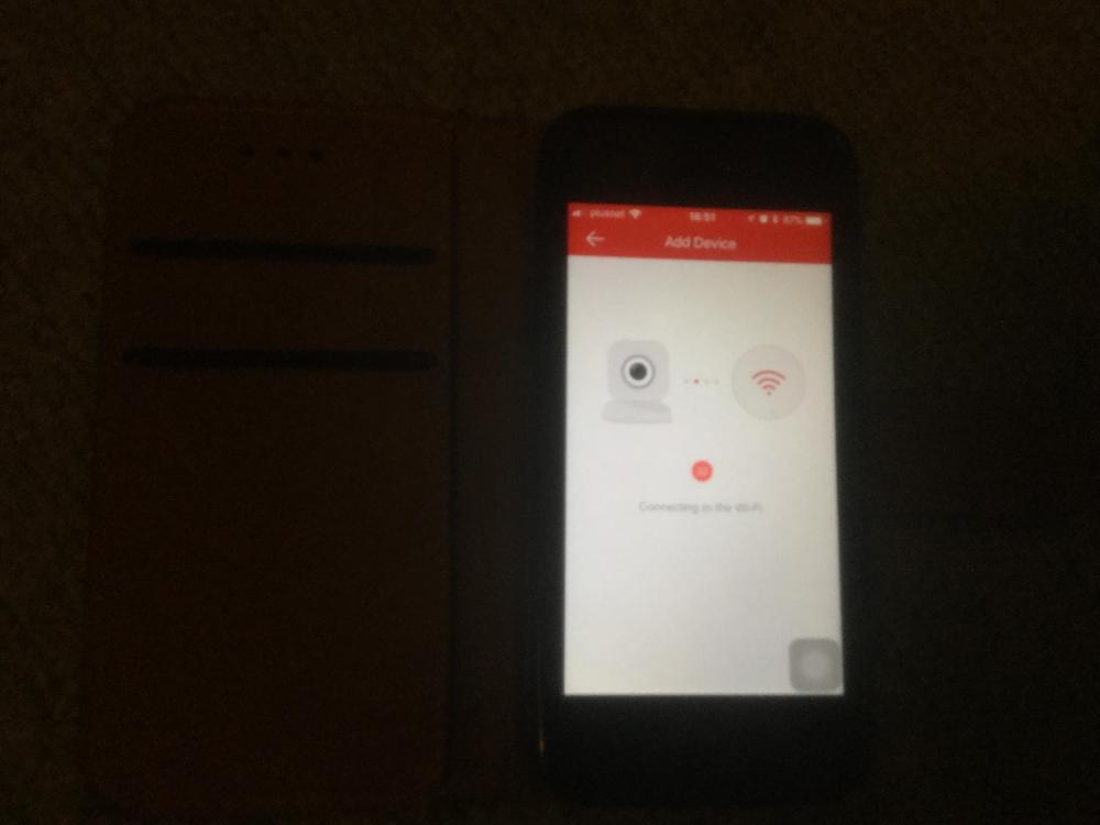

On 04/03/2019 at 16:26, james.wilson said:
I am sorry to bother you guys again , I am trying to connect the WiFi and it is just failing and can not connect to the app. It has registered the Device, it confirm it has registered the WiFi and server,  it scans the QR Code and after that it does not connect to the app and and the WiFI does not seem to connect or open the app, keep getting message WiFi speed slow, or WiFi to far, so I dismantle the door Hikvision video door bell ring and placed it next to the router and still get the same message. Before it was connected front door of the house and it had the same issue. Any ideas what could be wrong. Appreciate if you can advice.
I get the solid blue light, but don’t seem to connect the WiFi or open the hik connect app.2B46FAD3-A882-4CC7-A8F5-DAD33DC187A3.thumb.jpeg.4314835ce4daac4da4359cc310069f55.jpeg66B9D9AA-416E-4CD4-9271-881E11E7D4BD.thumb.jpeg.f4fda81172095304b2be277287f79dac.jpeg

What router do you have ?
Default the router to factory settings and default the doorbell and try again
If you can't get passed the WiFi issue try taking the doorbell elsewhere ms try it on another WiFi router , just so you can narrow down where the problem is
Also did you buy this new or used?  I would see if the device needs an update of firmware but  be difficult if it's not connecting .....
You can hard reset the device by holding down the reset button on the left of the unit (I think you hold it down for 15 seconds)
I would try that then try again to reconfigure

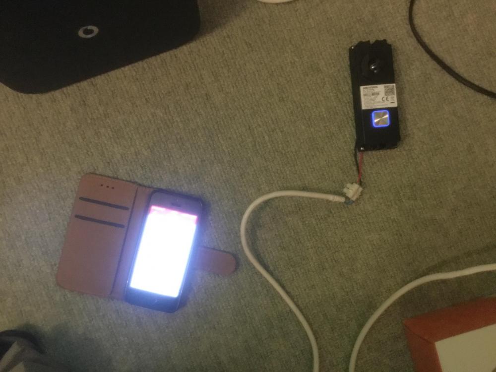

Dear All,
Sorry for the late reply and the problem I had, was the transformer power was not strong enough, as I wanted to use the 8V 1amp transformer to see if it works,as I purchased 2nd hand.
What happened was the red light was flashing on the video Door bell and the chime was ringing it self every minute, so I was messing around what could be the problem. What is was the Bell chime was taking all the power, so this is why the video door bell would not connect at the first attempt to the Wifi.
So I dismantle door bell, took the existing transformer out and took it in the room next to the Vodafone router and I could not get it going and again messed around for few hours.
I went out and came back late at 12 midnight and started to mess around and hey Presto it scanned the QR code and it registered the phone and I downloaded the HIK CONNECT app.
I Reset it by holding the button on the left facing towards me, which reset to factory setting, this was done few time at the 1st install and then 2nd attempt In the room. In the room it connect to Wifi and registered the Door bell, but it would not registered when fitted outside due to not enough power from Transformer. But it registered in the room, as the transformer was ONLY supplying the power to the Door bell and NOT Chime.

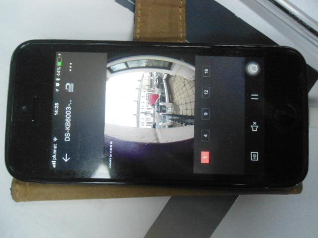

Device firmware is up to date. Firmware up to date Device version :V1.4.62 build 180515
It was about 2 month old confirmed by the seller. It is working fine and it takes time to load up and you need a good wifi. This is only down side of it and by the time you answer the parcel guy might be already gone, so this is what you guys said al long, but I am happy with it so far, as I paid around £50.00.
The good thing about it is it has the motion detection, so you get alerts and picture, so I know who has been like postman, my wife and Kids, so I can see what time they go in and out, so no more lies from the children coming home late, while I am in bed Lol at Weekends.
You can see from the images I have attached  it works fine, so I kept it in the room all day Sunday and it worked, so I fitted it now and dismantle the wires from the Byron Ding Dome chime and the Hikvision door bell works fine and I get motion detection. if I connect the  Byron Ding Dome chime , then the Hikvision video door bell not work, as the Chime will take all the power, due to using the existing transformer.
I spoke to Hikvison technical and they told me the Video door bell will operate at 9 Volt, so even if I get 12 Volt it will do the both chime and Video doorbell. But I rather get the 3 voltage, so in future if there is a problem, I have the 16Volt and 24 Volt.
