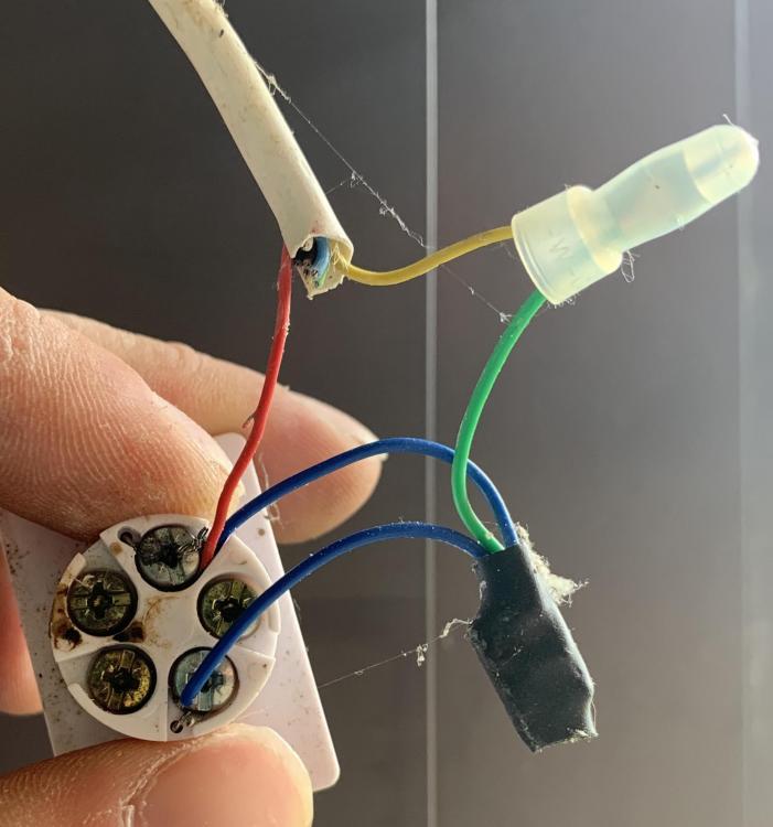

Sooty1988 Posted April 27, 2019 Posted April 27, 2019 Got problems with a Chubb Guardall system. Need to get a new one of these...but what are they...id biscuits?? Chubbs own? Can’t find anything to help me so any help greatly appreciated. Quote
al-yeti Posted April 27, 2019 Posted April 27, 2019 19 minutes ago, Sooty1988 said: Got problems with a Chubb Guardall system. Need to get a new one of these...but what are they...id biscuits?? Chubbs own? Can’t find anything to help me so any help greatly appreciated. Looks like it, cut heat shrink off should have a number on it maybe? Quote
PeterJames Posted April 27, 2019 Posted April 27, 2019 Might just be EOL's in heatshrink I dont remember any ID Chub/guardall tat Quote
sixwheeledbeast Posted April 27, 2019 Posted April 27, 2019 They are the special parallel Guardall EOL's, highly doubt it would be faulty and could be tested with a meter. Quote
Sooty1988 Posted April 27, 2019 Author Posted April 27, 2019 Thanks everyone for your help I’ll give it a try. Got to get Chubb in to default the engineer code/pin of the day rubbish as well. Hopefully the customer will just go for the Texecom system we recommend. Quote
sixwheeledbeast Posted April 27, 2019 Posted April 27, 2019 I wouldn't recommend taking over a PX if you have never used them before. Also you will need to replace all the EOL modules and possibly some devices if you swap the controls. Quote
Nova-Security Posted April 28, 2019 Posted April 28, 2019 Its as above EOL resistors in heat shrink made by elemdene 8K2 / 8K2 Quote www.nova-security.co.uk www.nsiapproved.co.uk No PMs please unless i know you or you are using this board with your proper name.
Sooty1988 Posted April 28, 2019 Author Posted April 28, 2019 4 hours ago, Nova-Security said: Its as above EOL resistors in heat shrink made by elemdene 8K2 / 8K2 Thanks I’ll get in contact with them. 1 Quote
