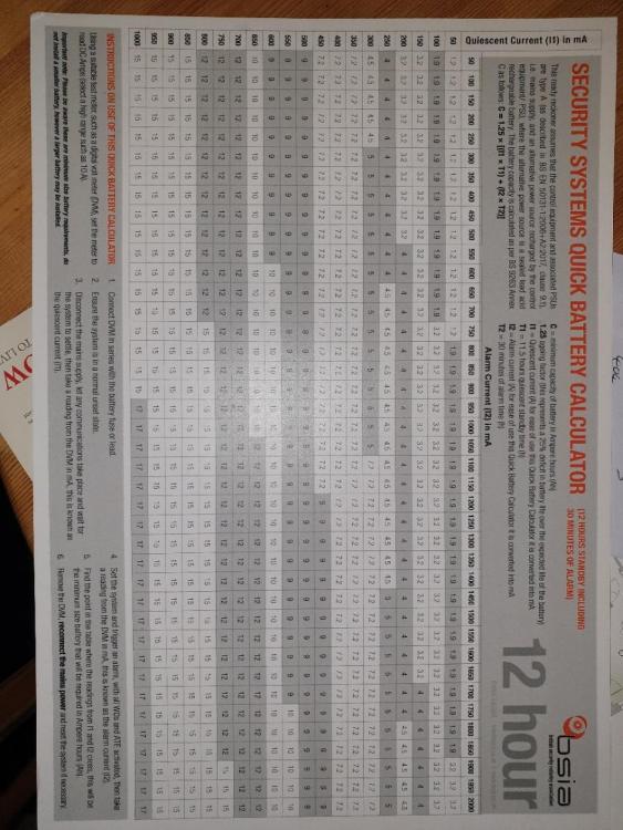

Have you tried a site Search ?, Sure there's a calculator on here somewhere.
Customers Love us, Intruders Hate us.
Take a look at the nsi site, there's a quick & simplified calculator on there.

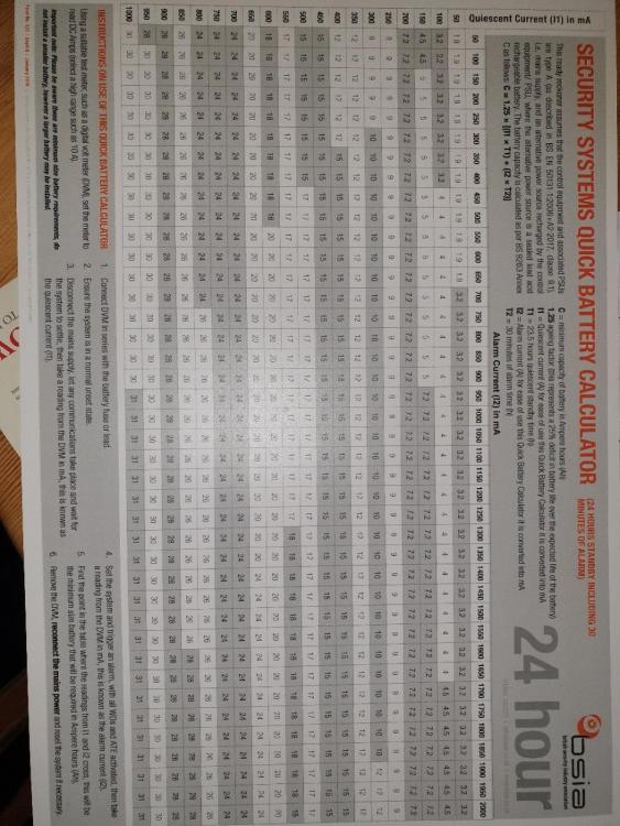

I always thought it was x 1.2 but the BSIA example shows 1.25.
Every day is a school day as they say  :unsure:
I recall it as 15 minute activation not 30 minutes. Seen as the bell timer would be 15 minutes the alarm current after 15 minutes will be different on an SAB.
Was sure the standard says something along the lines of "12 (24) hours standby including one full activation"?
Still useful chart tho, not a bad thing to be overspec standby capacity wise.
  • 3 months later...
30 mins for fire alarms.
15 mins intruder.
