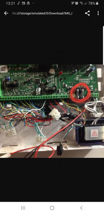

Hi Muhammad: Was the fuse just open circuit when you checked it or were there little globe of metal on the glass ?.
Andy
Sorry that should have read Globs of metal on the glass ?
Edited by Specialist
Customers Love us, Intruders Hate us.
Hi Muhammad: Sorry buddy bit hard to tell from the picture, if the fuse has just opened: No globs of metal visible and no Blackening of the glass, you may have been lucky and it died due to ageing. It would be a good idea to gently squeeze the ends of the Fuse holder together slightly to make sure it makes good contact with the fuse, a loose fuse holder can sometimes kill off a fuse early.
If the fuse hasn't blown again since fitting the replacement, you may be ok. I would suggest doing a test on your outside siren though, just to make sure it still works ok.
Andy
Posted (edited)
No problems buddy, glad it seems to have worked for you. If you have any other problems with it, feel free to come back and ask again. There's always someone floating around to help out.
Just one thing that's a bit concerning, where is your battery ?. Seems to be missing from your panel, without the battery you have no protection if you have a power cut.
Andy
