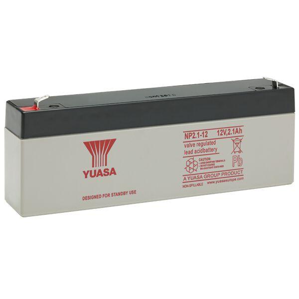

Also am i looking at replacing it with a battery like this on...accenta-mini-gen4-alarm-battery-4931-p.j

Sorry, I missed answering part of your original question. Yes the battery you show should be fine as a replacement in your panel.
