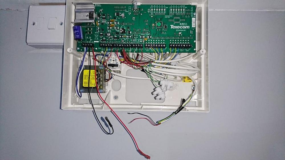

Snakecharmer Posted June 11, 2019 Posted June 11, 2019 Can anyone advise on my system. Fitted professionally? There does not seem to be a siren/speaker. I would be grateful for some advice on getting one to fit. Regads. Quote
sixwheeledbeast Posted June 11, 2019 Posted June 11, 2019 Speaker is built in located under the circuit board but it's possible it's not working. Quote
james.wilson Posted June 11, 2019 Posted June 11, 2019 Id guess at not installed by an alarm professional but would need to know more about the issue. It shouldnt have a switched spur but at least its got one Quote securitywarehouse Security Supplies from Security Warehouse Trade Members please contact us for your TSI vetted trade discount.
Snakecharmer Posted June 11, 2019 Author Posted June 11, 2019 Thanks, I can see wires going into terminals LS - and + but can't see where they lead. can you recommend a one I can purchase and disregard the original please? Oh! And thanks for the prompt reply. Chris Quote
james.wilson Posted June 11, 2019 Posted June 11, 2019 4 minutes ago, Snakecharmer said: Thanks, I can see wires going into terminals LS - and + but can't see where they lead. can you recommend a one I can purchase and disregard the original please? Oh! And thanks for the prompt reply. Chris are they on a 6 core leaving the panel? Quote securitywarehouse Security Supplies from Security Warehouse Trade Members please contact us for your TSI vetted trade discount.
sixwheeledbeast Posted June 11, 2019 Posted June 11, 2019 Any 16 Ohm Loudspeaker like a CQR Alto for example. Quote
Snakecharmer Posted June 11, 2019 Author Posted June 11, 2019 Sorted now thanks. Greatly appreciated. Chris Quote
