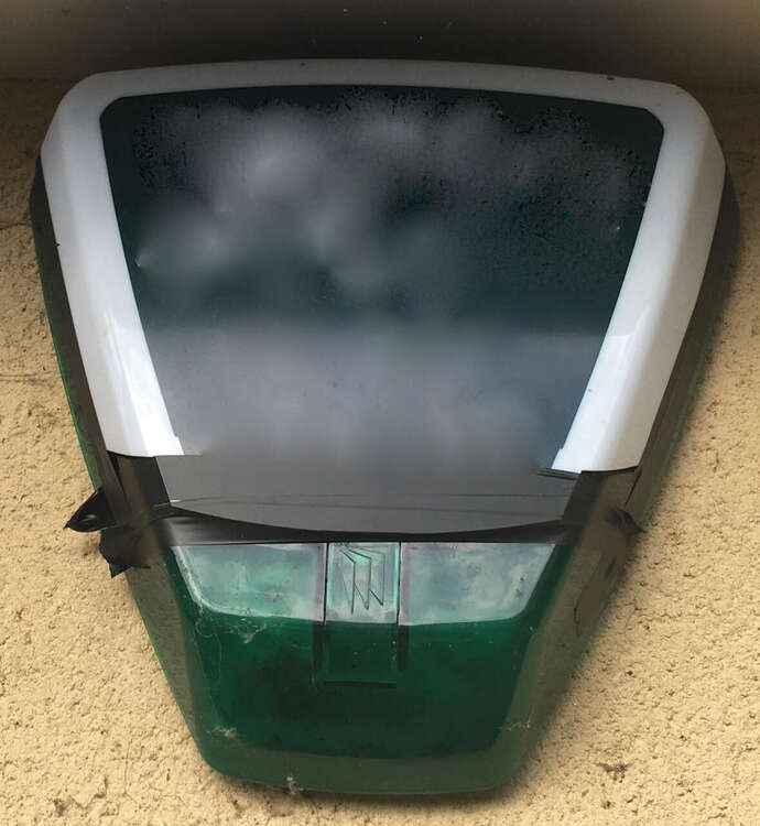

cheddarman Posted July 3, 2019 Posted July 3, 2019 (edited) During a fit of anger when the alarm wouldn't silence itself, I had to force open the outdoor cabinet to disconnect the klaxon as I have no instructions as to how to open it properly! Can someone please advise how this sort of cabinet should be opened and also where I can get a replacement cover (white bit) please? Edited July 3, 2019 by cheddarman Quote
james.wilson Posted July 3, 2019 Posted July 3, 2019 That bit below the white in the centre levers out to show a cover screw Quote securitywarehouse Security Supplies from Security Warehouse Trade Members please contact us for your TSI vetted trade discount.
sixwheeledbeast Posted July 3, 2019 Posted July 3, 2019 The thing with the Pyronix Logo on falls out if you poke it, then you can access the only lid screw. Quote
cheddarman Posted July 4, 2019 Author Posted July 4, 2019 Many thanks guys, with the alarm going off I didn't waste time prodding around! Quote
sixwheeledbeast Posted July 4, 2019 Posted July 4, 2019 Normally smashing at things makes it worse. Hopefully it only needs a new cover. Quote
