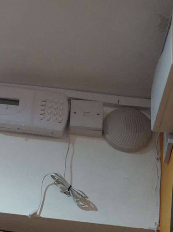

al-yeti Posted July 22, 2019 Posted July 22, 2019 I think they gave up to , just seen this in Brum , no not working here jw lol Quote

datadiffusion Posted July 22, 2019 Posted July 22, 2019 Nice choice of speaker, though Quote So, I've decided to take my work back underground.... to stop it falling into the wrong hands

BearKnots Posted July 22, 2019 Author Posted July 22, 2019 5 minutes ago, datadiffusion said: Nice choice of speaker, though Not my speaker if you mean the one in the picture from Al Yeti? I just using a cheap Kinetics one. Quote
datadiffusion Posted July 22, 2019 Posted July 22, 2019 (edited) Ah right I thought that was yours! I fit those speakers myself. Anyway, if you paid what Alert are listing for the GJD *and* you can get a refund, I strongly, strongly suggest you get a refund and swap it for this... https://www.ebay.co.uk/itm/GSM-TELL-Pager3-Z6-6-input-auto-dialer-communicator/323864542434?hash=item4b67d4bce2:g:qAQAAOSw0NtbXesQ This is the 6 'zone' version of the other one I posted. It's simple to use (it also has an optional mode where it is a complete alarm as it supports keyswitch entry/exit zones etc... and I've fitted them to fast food vans) But out of the box it works as a straightforward 6 channel GSM messenger. It also has separate 'restore' messages so you would know if the alarm had been reset (if someone else has the code!). It would at least fit inside the case, and is a dream to program via any windows PC with a USB cable (it even has the software built in whcih dl's when you first connect) Edited July 22, 2019 by datadiffusion Quote So, I've decided to take my work back underground.... to stop it falling into the wrong hands
al-yeti Posted July 22, 2019 Posted July 22, 2019 1 hour ago, datadiffusion said: Ah right I thought that was yours! I fit those speakers myself. Anyway, if you paid what Alert are listing for the GJD *and* you can get a refund, I strongly, strongly suggest you get a refund and swap it for this... https://www.ebay.co.uk/itm/GSM-TELL-Pager3-Z6-6-input-auto-dialer-communicator/323864542434?hash=item4b67d4bce2:g:qAQAAOSw0NtbXesQ This is the 6 'zone' version of the other one I posted. It's simple to use (it also has an optional mode where it is a complete alarm as it supports keyswitch entry/exit zones etc... and I've fitted them to fast food vans) But out of the box it works as a straightforward 6 channel GSM messenger. It also has separate 'restore' messages so you would know if the alarm had been reset (if someone else has the code!). It would at least fit inside the case, and is a dream to program via any windows PC with a USB cable (it even has the software built in whcih dl's when you first connect) This is junk lol 1 hour ago, BearKnots said: Not my speaker if you mean the one in the picture from Al Yeti? I just using a cheap Kinetics one. Go with this and you will get support aswell https://www.adventcontrols.co.uk/collections/gsm-alarm-dialers/products/gsm-alarm-auto-dialer-sms-sender-6-channel-remote-voltage-measurement-monitoring If suitable Quote
