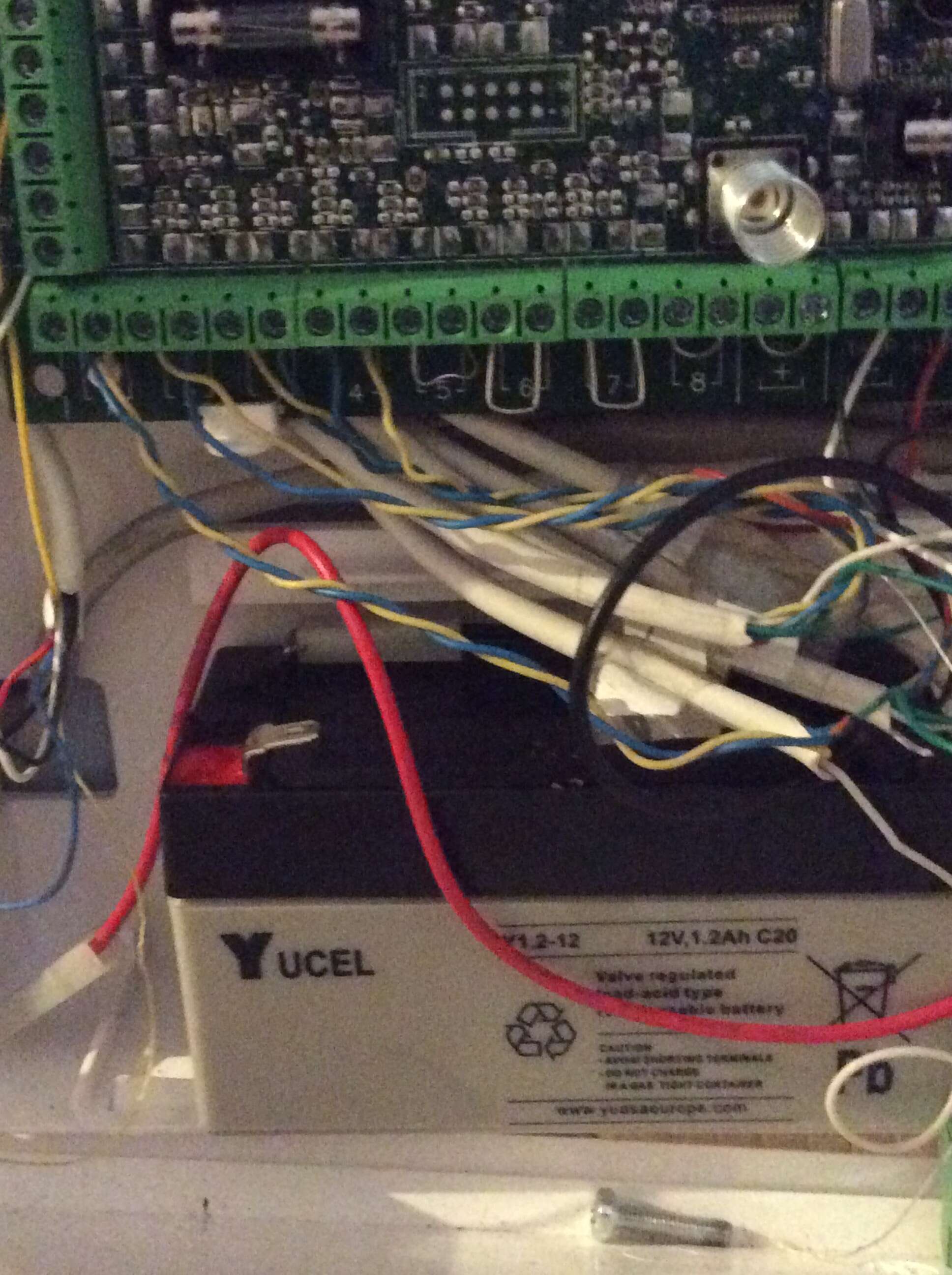

Paul mc1888 Posted August 3, 2019 Posted August 3, 2019 Just fitted a new Accenta G4 and the keypad is blank. Check the terminal and there is power to the keypad. Check the continuity and all connections are ok. The sounder is going as well. Any ideas Quote
james.wilson Posted August 3, 2019 Posted August 3, 2019 Check there is data getting to the keypad. Disconnect all keypad connections and test it on the cp on a short temp wire Quote securitywarehouse Security Supplies from Security Warehouse Trade Members please contact us for your TSI vetted trade discount.
Paul mc1888 Posted August 3, 2019 Author Posted August 3, 2019 James thanks. Done all the tests and even connected to old alarm and still nothing on the lcd. The keypad does not light up either. Tried new battery also. The sounder is also going off as well. Quote
james.wilson Posted August 4, 2019 Posted August 4, 2019 If its not doing anything and it has 12v at the keypad terminals I'd say you have either blown it or its doa Quote securitywarehouse Security Supplies from Security Warehouse Trade Members please contact us for your TSI vetted trade discount.
Paul mc1888 Posted August 4, 2019 Author Posted August 4, 2019 Thanks James checked everything again this morning. Will pick up another keypad tomorrow and fingers crossed Quote
al-yeti Posted August 4, 2019 Posted August 4, 2019 On 04/08/2019 at 13:38, Paul mc1888 said: Thanks James checked everything again this morning. Will pick up another keypad tomorrow and fingers crossed Expand You got any pictures of your wiring ? Quote
