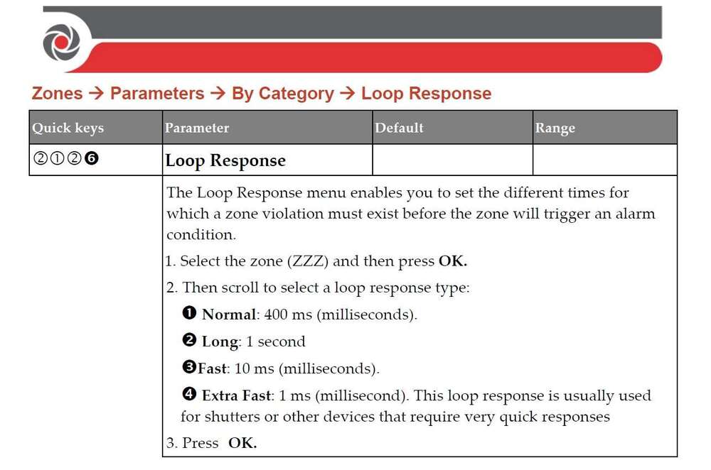

mauog Posted August 6, 2019 Posted August 6, 2019 Hello, I have some rope sensors installed on my rolling shutters. I have a Risco Plus system. According to the handbook I set the "loop response" to "extra fast, 1ms". I would like to know if there is a recommended value for the pulse count value. I can understand that it could depend on sensor brand but I'm figuring out if there is any value to be set that come from general experience. Thank You Regards Quote

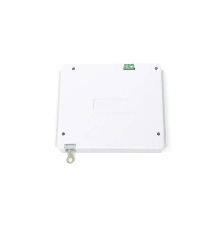

mauog Posted August 6, 2019 Author Posted August 6, 2019 2 hours ago, james.wilson said: What's a 'rope' sensor? I don't know what is exactly the name in english but here you are... Quote
datadiffusion Posted August 6, 2019 Posted August 6, 2019 I have to admit I'm not entirely sure what *that* device is in English Is it for an automatic roller door? Quote So, I've decided to take my work back underground.... to stop it falling into the wrong hands
mauog Posted August 6, 2019 Author Posted August 6, 2019 You have to connect the rope to the end of the shutter. So as soon as the shutter moves the rope moves in or out to the device opening the circuit. 1 Quote
al-yeti Posted August 6, 2019 Posted August 6, 2019 (edited) 3 hours ago, mauog said: You have to connect the rope to the end of the shutter. So as soon as the shutter moves the rope moves in or out to the device opening the circuit. Ok so this a movement detection device , fully compatible with bentel systems after a bit internet H stalking and Google translation https://www.ebay.co.uk/itm/ART471N-Sensore-a-fune-compatibile-Bentel-per-Antifurto-Tapparelle-avvolgibili-/182713252651 If you don't speak English , your phone should ask you to translate description to english Edited August 6, 2019 by al-yeti Quote
