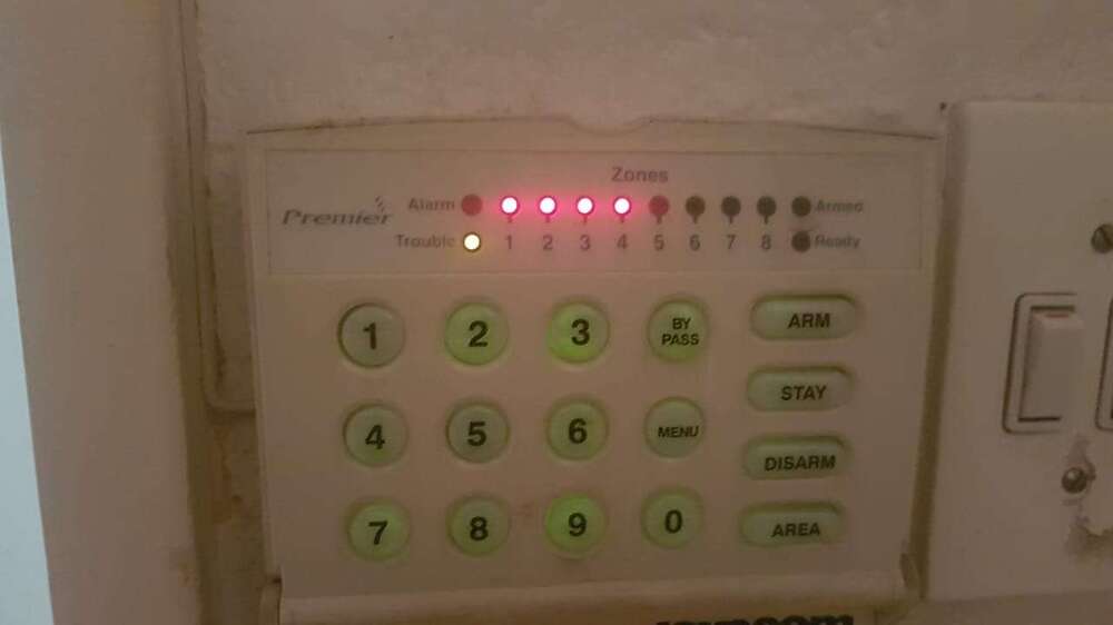

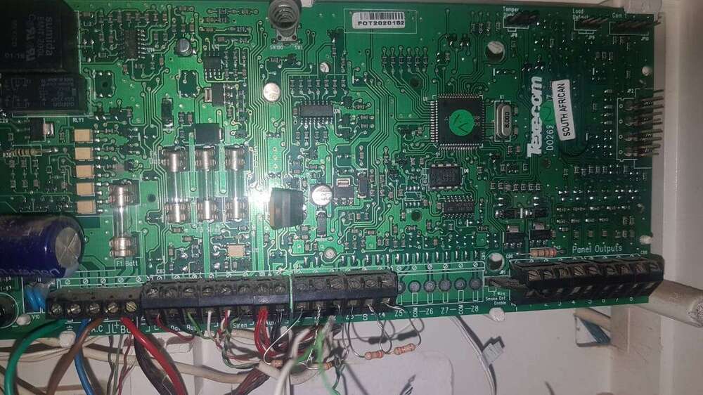

Shadrack Posted August 9, 2019 Author Posted August 9, 2019 I removed all sensors. I've added resistors to all zones (please check the pics if this is right?) and reset to default. I've programmed date and time. This is what I've got now: Quote
sixwheeledbeast Posted August 9, 2019 Posted August 9, 2019 99 to leave engineers? If so all zones and tamper is active Quote
Shadrack Posted August 9, 2019 Author Posted August 9, 2019 that is out of engineers. Engineers has all 8 lit up. I tried tamper disable pin on the controller, (has a 3 jumper pinout for Tamper Disable), same thing. Quote
al-yeti Posted August 9, 2019 Posted August 9, 2019 21 minutes ago, Shadrack said: that is out of engineers. Engineers has all 8 lit up. I tried tamper disable pin on the controller, (has a 3 jumper pinout for Tamper Disable), same thing. So if you disable tampers , then might be as Swb says the seol config and resistor combination? Quote
Shadrack Posted August 9, 2019 Author Posted August 9, 2019 Well I did nuke config back to defaults so it shouldn't be an issue? also I removed the broken reed and removed the wires so no more 2 reeds on 1 zone. as it is while I type this, all sensors removed, replaced with resistors. Quote
sixwheeledbeast Posted August 9, 2019 Posted August 9, 2019 May not be setup for resistors as default Quote
al-yeti Posted August 9, 2019 Posted August 9, 2019 8 minutes ago, Shadrack said: Well I did nuke config back to defaults so it shouldn't be an issue? also I removed the broken reed and removed the wires so no more 2 reeds on 1 zone. as it is while I type this, all sensors removed, replaced with resistors. Put wire links instead of resistors and see if anything changes Quote
