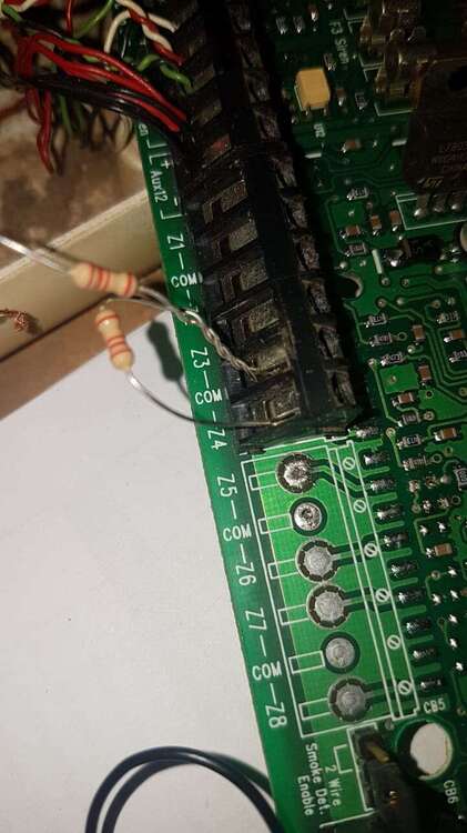

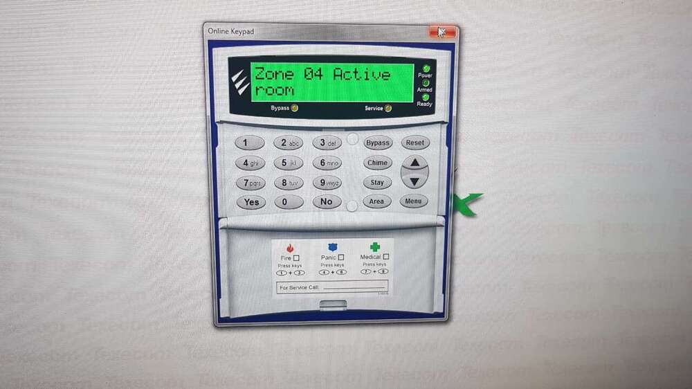

Shadrack Posted August 12, 2019 Author Posted August 12, 2019 (edited) Update: I have added the jumper/dupont in zone 4 between Com and Z4. Zone 4 is still active. (PS, there is another reply just before this I made on page 2, this overflows from that) I also then changed the dupont for a resistor to emulate EOL resistor Edited August 12, 2019 by Shadrack Quote

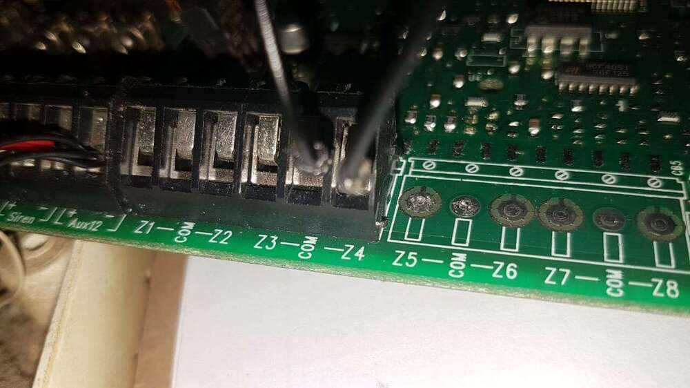

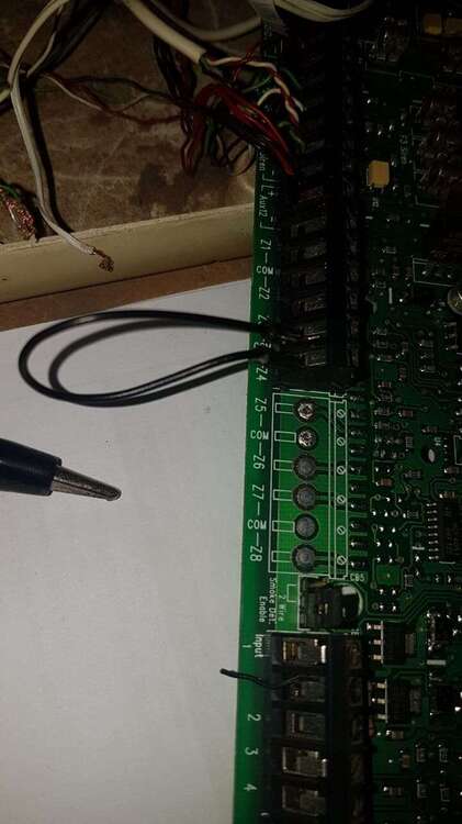

Shadrack Posted August 14, 2019 Author Posted August 14, 2019 Hi SWB, I removed all wiring per your instruction, set zone 1 to instant, wiring NO, partition one. here are the pics. Quote
sixwheeledbeast Posted August 14, 2019 Posted August 14, 2019 So does Zone 1 change state when you open and close the circuit? Quote
Shadrack Posted August 14, 2019 Author Posted August 14, 2019 Nope, no change with or without the jumper cable Quote
sixwheeledbeast Posted August 14, 2019 Posted August 14, 2019 Try and set the alarm with the circuit open then close the circuit to set the alarm off? Maybe try the 3 other zones too, you will have to program them in like zone 1. If nothing is changing state then it maybe knackered, I can't think of any other reason. Something seems broken if the panel is showing Ready but the NO circuit is closed. 1 Quote
Shadrack Posted August 14, 2019 Author Posted August 14, 2019 I've armed the armed partition 1 just fine. I then closed zone 1 through 4, one at a time, then all together, no changing of states at all. Quote
