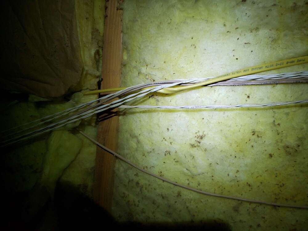

PatientOne Posted September 13, 2019 Author Posted September 13, 2019 (edited) Just checked in the attic and the new high voltage line (yellow in the picture below) does briefly cross over some of the alarm sensor wires (white twisted pairs). Some of those wires include zones that have been problematic, but some of the problematic zones come from the other side of the house and do not go anywhere near the new power line. That said, all the alarm wires do bundle together and terminate in near each other. Edited September 13, 2019 by PatientOne Quote
GalaxyGuy Posted September 13, 2019 Posted September 13, 2019 Does the zone issue appear when the new outlet is supplying current (microwave on full power) ? Set your meter to AC and measure between 0v and the zone connections to see if there's an issue. Try with the new outlet under load and off. For the image posted, I think it's unlikely that this is the issue. I don't know your panel, but doesn't it have a menu to show voltage sat zones and power rails being observed by the CPU? If not, then you'll need to debug by overriding zones with resistors at the panel. Quote
sixwheeledbeast Posted September 13, 2019 Posted September 13, 2019 Faults like this you need to break down to locate. Test the controls first voltages, batteries on and off mains, charging circuit, everything you would check on a service, look for instability or incorrect values. Then check the cabling and terminals both ends and as far as you can access, look for issues with resistance and tightness, ingress of water, damage to outer sheath. Compare with your as fitted documents. After this you need to consider if it's a device, you could do this by removing it and leave the cable active or swapping known good devices around. Quote

PatientOne Posted September 13, 2019 Author Posted September 13, 2019 11 hours ago, GalaxyGuy said: Does the zone issue appear when the new outlet is supplying current (microwave on full power) ? Set your meter to AC and measure between 0v and the zone connections to see if there's an issue. Try with the new outlet under load and off. For the image posted, I think it's unlikely that this is the issue. Running some zones directly to a multimeter is showing between 1.2 and 1.4 millivolts when closed (slightly different for different zones). Running the microwave doesn't affect that. 11 hours ago, GalaxyGuy said: I don't know your panel, but doesn't it have a menu to show voltage sat zones and power rails being observed by the CPU? If not, then you'll need to debug by overriding zones with resistors at the panel. You mean by just unhooking a zone and checking the resistance? With the resistors installed the resistance that I'm seeing appears to be stable, around 3k for each zone. That said the open signals being reported seem to be instantaneous so I'm not sure I'd even be able to observe one on a multimeter if I waited. Currently they're happening every 10-20 minutes. 6 hours ago, al-yeti said: So these zones connected wired to the QH16 , and the QH16 has an antennae to send back signal to the main panel? Yep. I would think the problem lines in the QH16 and that the controller just reports whatever is sent to it by the QH16. Quote
james.wilson Posted September 13, 2019 Posted September 13, 2019 Bypass them at the controller and soak test then the same at the sensor it may be the controller has failed Quote securitywarehouse Security Supplies from Security Warehouse Trade Members please contact us for your TSI vetted trade discount.
