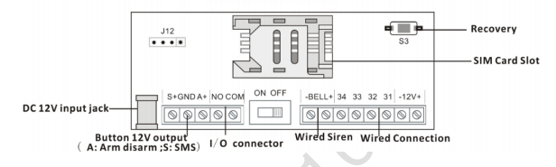

ALS57 Posted November 2, 2019 Posted November 2, 2019 Hi There Need a bit of advice wiring an old yale exterior alarm siren to a new GSM wired/wireless alarm panel Yale siren has 5 terminals - SRN and STB I think are Bell trig and RTN is bell tamper which isn't needed. The other two are obviously + and - 12V The new panel has just two + and - Bell and + and - 12V available. Sorry if this is obvious but can I ask if I can wire this old siren to the new box, I don't want to burn anything out Do I just wire SRN and STB to the Bell + and - and the Bell supply to + and - 12V on the panel? Thanks Al Quote
james.wilson Posted November 2, 2019 Posted November 2, 2019 Connect srn and stb to bell - I'd assume that's a switched output. Is there no tamper input on the new one? Quote securitywarehouse Security Supplies from Security Warehouse Trade Members please contact us for your TSI vetted trade discount.
ALS57 Posted November 2, 2019 Author Posted November 2, 2019 Hi James, no tamper for a wired siren, only wireless Quote
