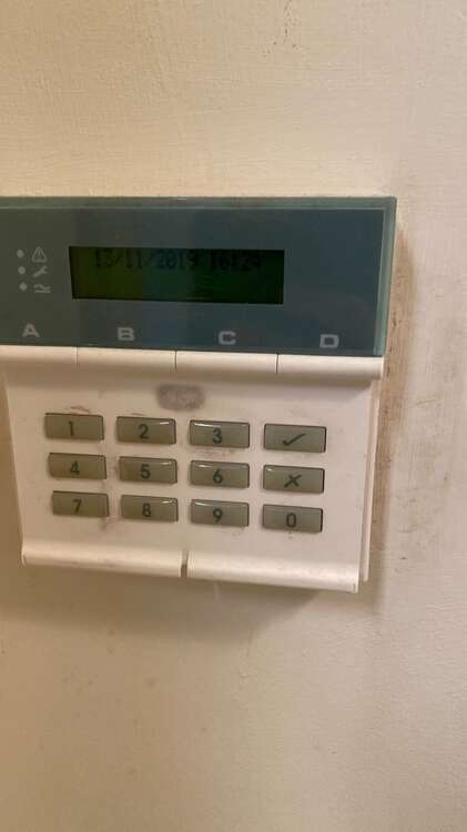

hankhank10 Posted November 13, 2019 Posted November 13, 2019 Evening I have just bought a house with an old, but seemingly functional, intruder alarm. I would like to replace the panel with a more modern one but can't identify the brand or model or where to start as there are no identifying marks or labels on it. Can anyone help me identify the panel below and point me towards suggestions for an upgrade option? Thanks! Quote
datadiffusion Posted November 13, 2019 Posted November 13, 2019 That's a Scantronic (now Eaton) 9x5x series alarm. It is old but you can still buy the 9651! (a basic 8 zone max version) Are you intending to fit the upgrade yourself, and what features are you looking for? When was the alarm last serviced? Quote So, I've decided to take my work back underground.... to stop it falling into the wrong hands
hankhank10 Posted November 13, 2019 Author Posted November 13, 2019 That's brilliant, thank you! I have no idea when the alarm was last serviced - perhaps never. I know that the old owners used it and reported no issues. At a minimum I would want to do a like-for-like replacement for a panel which isn't bashed and dirty. Would this be a simple job (ie read the manual, disconnect old one, reconnect new one with wires in the same place) for someone utterly unskilled (can wire a plug, not much beyond), or would I need to get a professional in? If there are upgraded versions which look more modern, have features such as unlocking with a keyfob / wifi connection then I'd be keen to upgrade to the latest version. I've got no appetite for a complete rework of the system - good enough is good enough for me. Thanks for your assistance in identifying it - wouldn't have known where to start otherwise. Quote
datadiffusion Posted November 13, 2019 Posted November 13, 2019 Sounds like a professional job then, also you would need to prove it is indeed 'good enough' by having the existing wiring and sensors checked (for operation, suitability and placement/coverage) before worrying about replacing it. e.g. have you got pets, are the existing sensors pet friendly? Do the sensors installed work? The next issue is that whilst I and many others can recommend a system, most installers will prefer their own system and most will install only that. Personally I would replace this alarm with an Eaton (Scantronic) i-On 40H which can handle up to 10 wired zones and any new sensors can be wireless, the keypad accepts fobs and you can also have radio fobs. The best bit is the free cloud app to you can monitor and control the alarm from a smartphone. Quote So, I've decided to take my work back underground.... to stop it falling into the wrong hands
