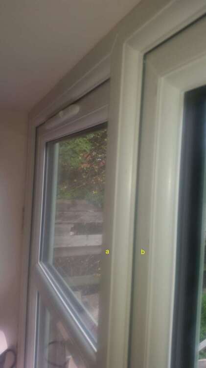

EDinMK Posted November 17, 2019 Author Posted November 17, 2019 Looks Good! But I have ANOTHER enigma, and i have watched videos on youtube etc ..but none seem to show this. Basically if you look at their windows (below) you can see the window is a GOOD 3/4 inch deeper than the actual frame. I mean i know the magnetic contact always goes window/door side. but even when closed it will be still a good 5mm away from even lining up opposing edges never mind facing ! and i am presuming it needs to be facing each other ....so would this be a "packer" job ? I mean I dont recall ever seeing a magnetic contact sitting or jutting out on what would be a lego brick block before or am i not looking LOL Quote
james.wilson Posted November 17, 2019 Posted November 17, 2019 Yes or use a flush cabled one and wire it into the shock etc Quote securitywarehouse Security Supplies from Security Warehouse Trade Members please contact us for your TSI vetted trade discount.
