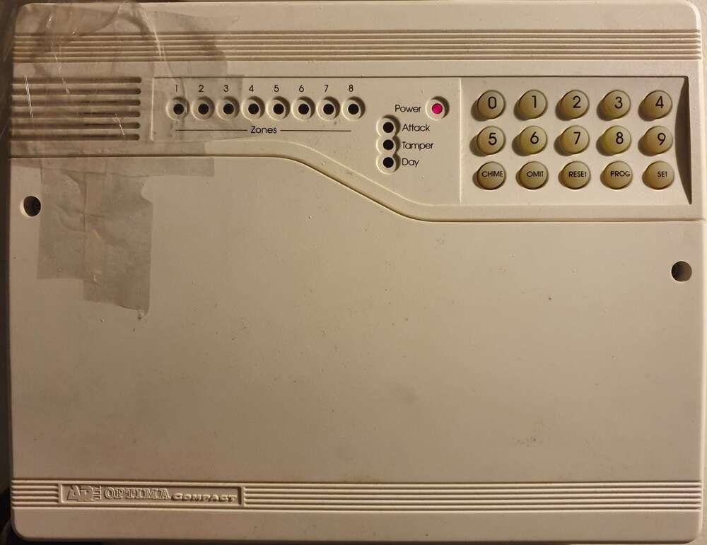

Giuseppe Posted December 16, 2019 Posted December 16, 2019 Hi, I have a ADE Optima Compact. the panel is making a continuous beep and only has the power light on. Tried pressing the keypad and doesnt seem to do anything. This started happening when I turned on the house mains power after changing a light switch. I did notice when the house mains power was off the security alarm outside triggered. Does anyone know what I can do to resolve this? Kind regards Quote
al-yeti Posted December 16, 2019 Posted December 16, 2019 On 16/12/2019 at 20:22, Giuseppe said: Hi, I have a ADE Optima Compact. the panel is making a continuous beep and only has the power light on. Tried pressing the keypad and doesnt seem to do anything. This started happening when I turned on the house mains power after changing a light switch. I did notice when the house mains power was off the security alarm outside triggered. Does anyone know what I can do to resolve this? Kind regards Expand Main battery inside alarm probably failed because it's never been serviced Quote
Giuseppe Posted December 16, 2019 Author Posted December 16, 2019 (edited) On 16/12/2019 at 22:06, al-yeti said: Main battery inside alarm probably failed because it's never been serviced Expand Think it was serviced about 10 years ago.... Can I replace the battery with a new one? or Shall I get an Engineer to service it? Kind regards Edited December 16, 2019 by Giuseppe Quote
al-yeti Posted December 17, 2019 Posted December 17, 2019 On 16/12/2019 at 23:49, Logan said: Its a optima g3. If its still beeping pull fuse out fuse spur and disconnect the loudspeaker Expand Logan be serious On 16/12/2019 at 23:05, Giuseppe said: Think it was serviced about 10 years ago.... Can I replace the battery with a new one? or Shall I get an Engineer to service it? Kind regards Expand If your going to use it then yes , engineer should check it's power unit, replace battery, walk test check external internal sirens and make sure it works Better to have some kind of park these days , then you could Lao get a quote for a new model , just depends on you, be preventative Quote
Giuseppe Posted December 17, 2019 Author Posted December 17, 2019 On 17/12/2019 at 00:20, al-yeti said: Logan be serious If your going to use it then yes , engineer should check it's power unit, replace battery, walk test check external internal sirens and make sure it works Better to have some kind of park these days , then you could Lao get a quote for a new model , just depends on you, be preventative Expand On 17/12/2019 at 00:23, Logan said: I am. And it turns out that is already what he did I reccomend for him to upgrade because the charging resistor is probably toast after being 10 years without service Expand Thank you. This is my first time looking at a security panel and really appreciate your help. If its just the battery I can easily change it and measure its power unit also. I can take it into work and see what I can find if its just the charging resistor that is toasted or if the circuit board needs repairing . If not, ask one of the senior electronics technicians to have a look. Either way I dont mind getting a new panel and found a G4 panel and battery online. Quote
al-yeti Posted December 17, 2019 Posted December 17, 2019 (edited) On 17/12/2019 at 00:46, Giuseppe said: Thank you. This is my first time looking at a security panel and really appreciate your help. If its just the battery I can easily change it and measure its power unit also. I can take it into work and see what I can find if its just the charging resistor that is toasted or if the circuit board needs repairing . If not, ask one of the senior electronics technicians to have a look. Either way I dont mind getting a new panel and found a G4 panel and battery online. Expand In that case get a battery try it , see if it's charging ok, no need to take panel off wall unless it's fried in some way Maybe if you got more budget get a panel that can also do some wireless circuits and so on Scanteonic ion40 might do you great DIY panel ,, (init databasher) Edited December 17, 2019 by al-yeti Quote
