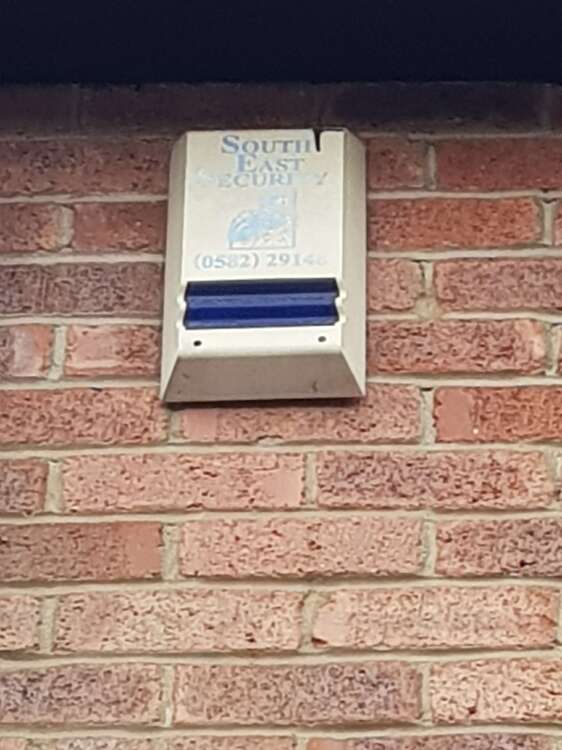

Guest Posted February 16, 2020 Author Posted February 16, 2020 On 11/02/2020 at 19:43, Logan said: Yes the 46 includes the install, programming and user guide Your bell box should be compatable (you can attach a picture if you want so i can verify that it is compatable) I believe the recall was for communication to ARC (alarm receiving centre) Hi Logan I have attached the bell box picture, I want to use this to start, with the aim of replacing it later in the year. 1 other question, do you need to be an installer to use the home control app on Pyronix? Quote
