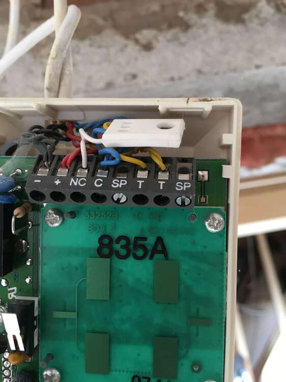

Pic of the PIR. Will remove the cover off the panel tomorrow and take a pic of the keypad. Had to remove and refit PIR earlier in the year and took pic so I could wire it back up properly just in case I cocked it up lol.
its DT...
  • Upvote 1
