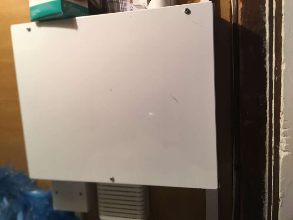

MrHappy Posted March 9, 2020 Share Posted March 9, 2020 4 hours ago, EECARE said: This is the main alarm panel, does anyone know what company this alarm panel is? Menvier Security Ltd who where dissolved in 2015 Quote Mr Veritas God Link to comment Share on other sites More sharing options...

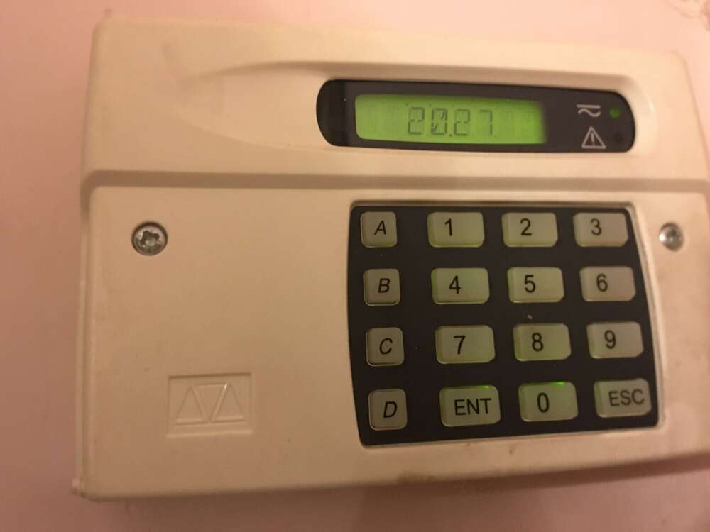

EECARE Posted March 10, 2020 Author Share Posted March 10, 2020 On 04/03/2020 at 07:52, PeterJames said: Whats wrong with the keypad? The keypad does not operate the numbering when entered Quote Link to comment Share on other sites More sharing options...

sixwheeledbeast Posted March 10, 2020 Share Posted March 10, 2020 Do the buttons not function at all (no beep) when you press them? Or is it just the wrong code. Quote Link to comment Share on other sites More sharing options...

MrHappy Posted March 10, 2020 Share Posted March 10, 2020 9 hours ago, EECARE said: The keypad does not operate the numbering when entered because their worn out, you need either new old stock or a remote control button repair doodar.... Quote Mr Veritas God Link to comment Share on other sites More sharing options...

EECARE Posted April 25, 2020 Author Share Posted April 25, 2020 Hi everyone one, and thank you for all you help. to update you all I bought a keypad from eBay and turned up at the customers place with the keypad. I opened the existing keypad and noticed that the keypad I had was not the same one. Also the alarm went off. so needed to think quick, I asked the client if he had son alcohol/spirits and he was helpful to give me a glass. so with a clean cloth I used the alcohol to clean the existing keypad, this was all going on with the alarm sounding. Have it a good wet clean with the Alcohol. After I put the face plate back on and tried the keypad, it seemed ok to me, so called the client to enter the passcode in and horay it worked. no question asked none answered. customer was happy. what a result. Easy Electrical Quote Link to comment Share on other sites More sharing options...
MrHappy Posted April 25, 2020 Share Posted April 25, 2020 it will work for a while.... 1 Quote Mr Veritas God Link to comment Share on other sites More sharing options...
datadiffusion Posted April 28, 2020 Share Posted April 28, 2020 Until the sugar in most alcoholic drinks as opposed to IPA fecks it up worse then the first time round anyway Quote So, I've decided to take my work back underground.... to stop it falling into the wrong hands Link to comment Share on other sites More sharing options...
