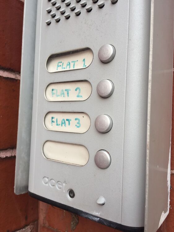

nwpattesting Posted April 26, 2020 Posted April 26, 2020 Hi, I have an old acet door entry system, buzzer and handset for 3 flats, not sure what model pic attached. One of the flats says he gets a whining noise some nights, and goes to the box and hears a whine from that too. Ive just had a fire alarm fitted, but I think he had it before that ? Can anyone please help ? thanks Quote
james.wilson Posted April 26, 2020 Posted April 26, 2020 Mic levels too high and feedback. Plus is the on hook switch broke / need adjusting? Quote securitywarehouse Security Supplies from Security Warehouse Trade Members please contact us for your TSI vetted trade discount.
PeterJames Posted April 27, 2020 Posted April 27, 2020 Also check that all handsets are seated correctly, feedback is often caused if someone hasnt replaced their handset properly Quote
nwpattesting Posted April 27, 2020 Author Posted April 27, 2020 Thanks for your help Peter will do Quote
nwpattesting Posted April 28, 2020 Author Posted April 28, 2020 I checked but cant see any volume adjustment on the mic. So I guess the problem is the handset, not gained access to check that yet. Quote
james.wilson Posted April 29, 2020 Posted April 29, 2020 29 minutes ago, nwpattesting said: I checked but cant see any volume adjustment on the mic. where did you look? Quote securitywarehouse Security Supplies from Security Warehouse Trade Members please contact us for your TSI vetted trade discount.
al-yeti Posted April 29, 2020 Posted April 29, 2020 32 minutes ago, nwpattesting said: I checked but cant see any volume adjustment on the mic. So I guess the problem is the handset, not gained access to check that yet. Normally two pots I thought Quote
GaryO Posted April 3, 2021 Posted April 3, 2021 As it’s happening at night, I wonder if one of the users is leaving the handset off the hook (thinking it won’t disturb them)? If they leave it flat in a surface you are likely to get feedback from that. Quote
