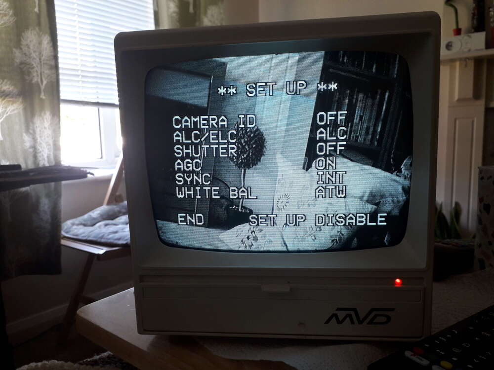

Guest Posted May 28, 2020 Posted May 28, 2020 10 hours ago, james.wilson said: What do you mean 'set up'? How to change the camera settings I think i might need a external case aswell Quote
james.wilson Posted May 28, 2020 Posted May 28, 2020 is it a programmable one, it probably only has a light level pot Quote securitywarehouse Security Supplies from Security Warehouse Trade Members please contact us for your TSI vetted trade discount.

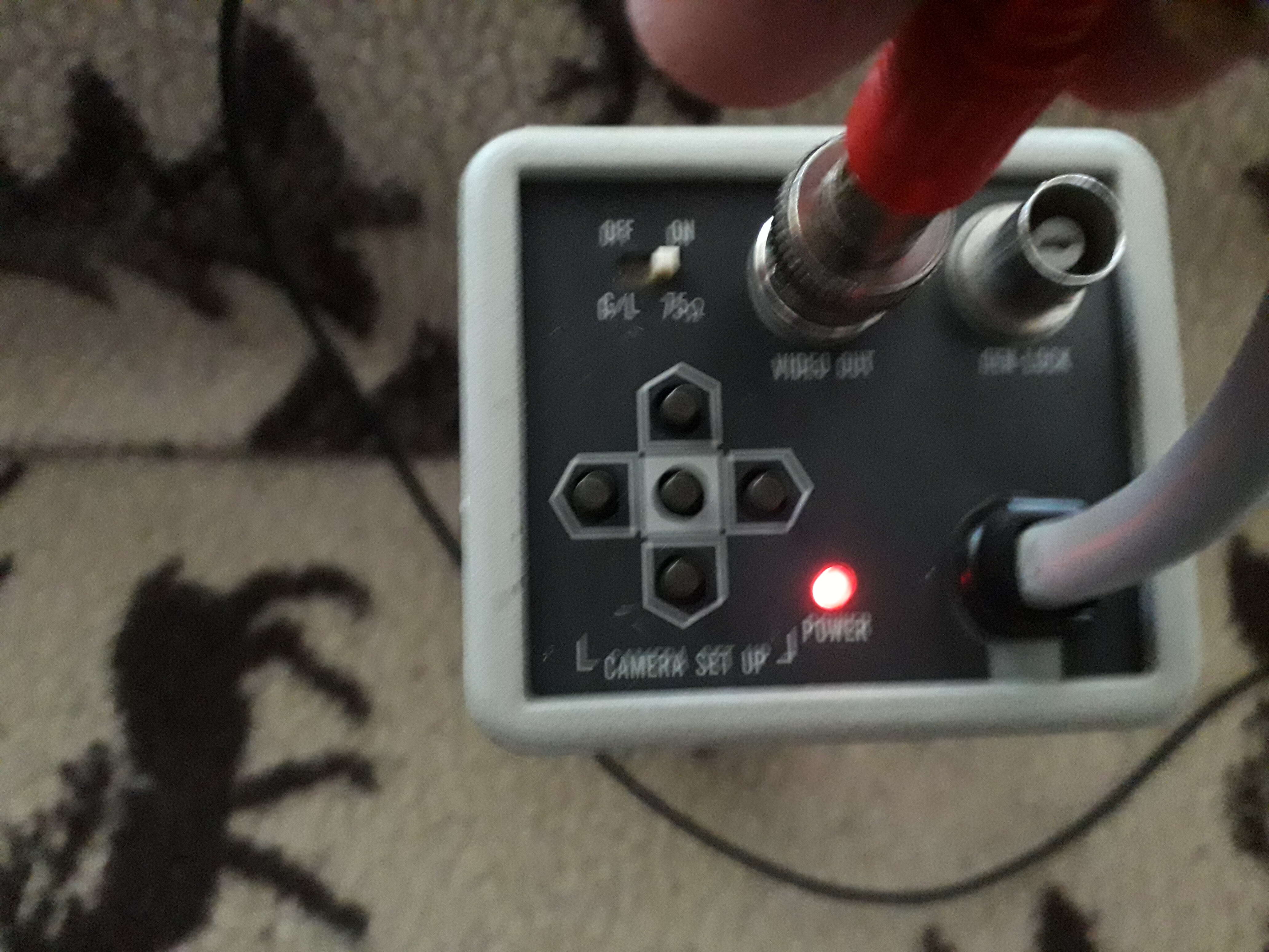

Guest Posted May 28, 2020 Posted May 28, 2020 (edited) 1 hour ago, james.wilson said: is it a programmable one, it probably only has a light level pot I can get into the menu but i can't seem to change the settings Edited May 28, 2020 by Guest Quote
james.wilson Posted May 28, 2020 Posted May 28, 2020 does it have bottons on the unit. or a data connection, maybe post pictures of all the sides of the camera Quote securitywarehouse Security Supplies from Security Warehouse Trade Members please contact us for your TSI vetted trade discount.

james.wilson Posted May 28, 2020 Posted May 28, 2020 if the menu buttons dont work to move through the menu id says its had it. Quote securitywarehouse Security Supplies from Security Warehouse Trade Members please contact us for your TSI vetted trade discount.
Guest Posted May 28, 2020 Posted May 28, 2020 44 minutes ago, norman said: It's the thing we press to ban people, be careful... I have a hammer that bans people on my fourms 37 minutes ago, james.wilson said: if the menu buttons dont work to move through the menu id says its had it. Ive figured it out now you must go to the bottom of the menu and click set up disable Quote
