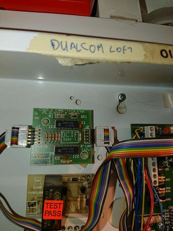

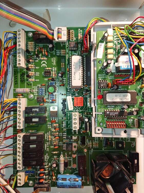

PeteGBR Posted September 12, 2020 Author Posted September 12, 2020 Ahh. Working out from description is hard i know. I took pictures for you. Quote

MrHappy Posted September 12, 2020 Posted September 12, 2020 if the dualcom is in the loft & is working.... the modem may have been for downloading, remove it or find a something to make it think its connected to a telephone line ? Quote Mr Veritas God
sixwheeledbeast Posted September 12, 2020 Posted September 12, 2020 There is no way to disable the line monitoring with a plug on DC58, you would have to put a line on it and hope it's in low security mode. Surely just ditching the DC58 will stop the line fault? Certainly the case on a TS Quote
PeteGBR Posted September 12, 2020 Author Posted September 12, 2020 Removing the gateway module previously fault caused a line fault. I'm not familiar with the 2500 at all past testing the alarm at service. I doubt the line fault is returned back from the dualcom either. The gateway board is supposed to be an ethernet adapter but is probably causing the existing line fault. I want to remove it and I'm asking where in the menu's I can find the flag to stop the endstation looking for it. Quote
james.wilson Posted September 13, 2020 Posted September 13, 2020 The gateway module is the master keypad. The extra pins on the plugon footprint is the 485 for it. You can remove the modem from it though Quote securitywarehouse Security Supplies from Security Warehouse Trade Members please contact us for your TSI vetted trade discount.
