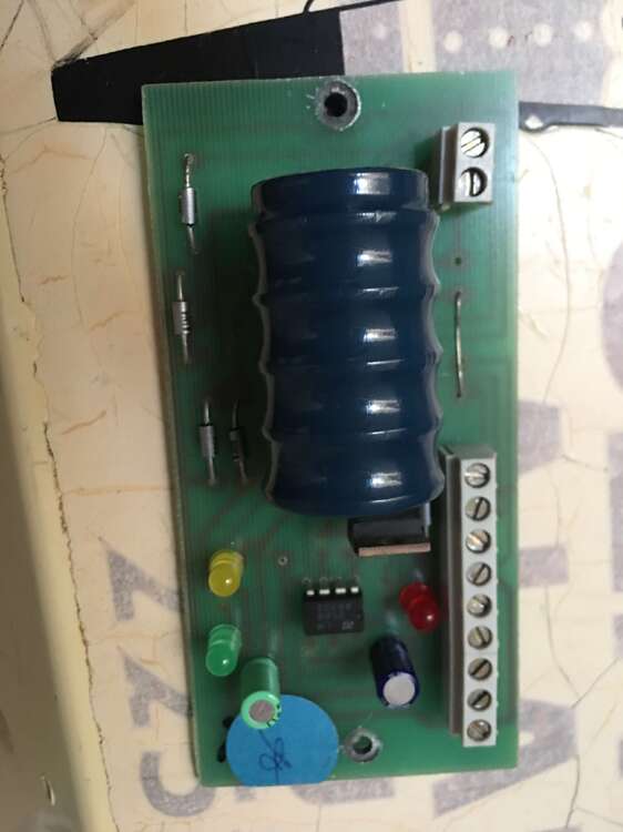

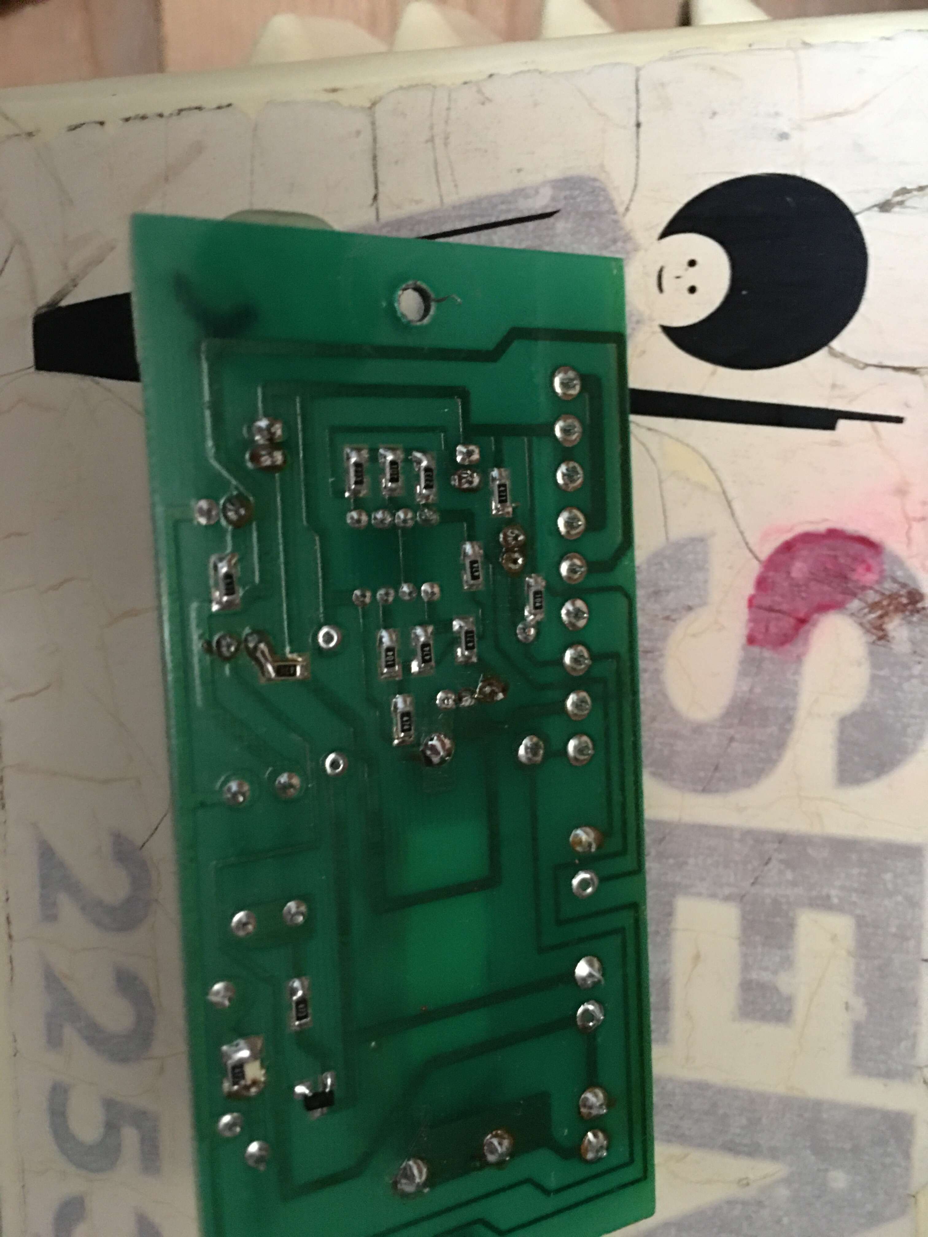

sterling t Posted September 18, 2020 Posted September 18, 2020 i need help with connections. there is no label saying what terminal does what. i would be greatful if anyone can help Quote
al-yeti Posted September 18, 2020 Posted September 18, 2020 24 minutes ago, sterling t said: i need help with connections. there is no label saying what terminal does what. i would be greatful if anyone can help You know how to trace components? As ground and +12 should be easy to find Quote
sterling t Posted September 18, 2020 Author Posted September 18, 2020 i have traced it a bit. things like tamper and trigger are a bit harder to find Quote
Nova-Security Posted September 18, 2020 Posted September 18, 2020 (edited) See which terminal is linked to the transistor then that should be your sounder output Does the chip have 555 on it, as with a couple of caps that your timing circuit so your trigger would go to that chip Edited September 18, 2020 by Nova-Security Quote www.nova-security.co.uk www.nsiapproved.co.uk No PMs please unless i know you or you are using this board with your proper name.

sixwheeledbeast Posted September 18, 2020 Posted September 18, 2020 Your best option is to trace everything back from the components. I doubt anyone will have any info about it. Maybe the terminals where labelled on the bells plastics originally. I can't read the chip well from your images but the IC's possibly an opamp, it's datasheet will help Quote
