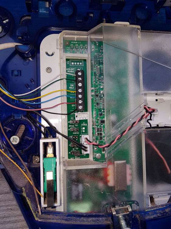

Moiser Posted October 16, 2020 Author Share Posted October 16, 2020 Thanks for the response. Attached is a picture I took just so I had a reference for the wiring does this help? If not I can get a better picture tomorrow. Quote Link to comment Share on other sites More sharing options...

al-yeti Posted October 16, 2020 Share Posted October 16, 2020 4 hours ago, Moiser said: Thanks for the response. Attached is a picture I took just so I had a reference for the wiring does this help? If not I can get a better picture tomorrow. External battery? Quote Link to comment Share on other sites More sharing options...
al-yeti Posted October 16, 2020 Share Posted October 16, 2020 4 hours ago, Moiser said: Thanks for the response. Attached is a picture I took just so I had a reference for the wiring does this help? If not I can get a better picture tomorrow. This is the second bell? Or all wired up inside the control panel with both cables I never had an issue the plastics on the Delta bell , unless that backplate tamper screw has snapped the tab maybe possible Or as said Bel is faulty but then I would swap the modules round if easy for you , that way you will know it's not the bell module as fault should follow Leaves you with plastics and cabling issue Quote Link to comment Share on other sites More sharing options...
sixwheeledbeast Posted October 16, 2020 Share Posted October 16, 2020 If it's wired correctly then you can meter the tamper return. If they are in parallel in the panel this wouldn't help find the fault tho, would have to test up there which isn't ideal. You would normally do all bell tests from the panel on a service, getting up and disturbing the bell every year is only asking for trouble. 20-30 minutes sounds average for a smallish domestic. Plenty other tests would be done at the control panel as well as the other things you mention. To be fair while I'd suspect the tamper on the bell it could be anything, bell, cabling, or panel would need much further diagnosis with a meter. Quote Link to comment Share on other sites More sharing options...
