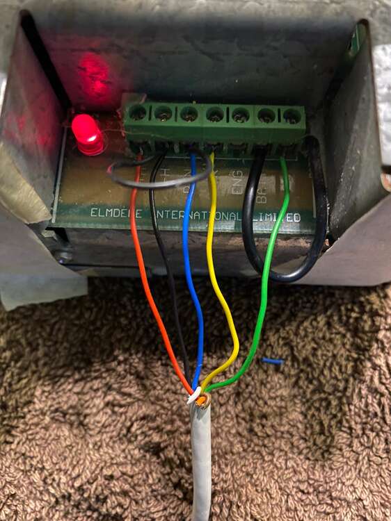

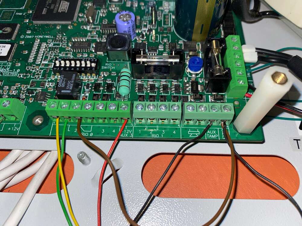

Keef Posted February 9, 2021 Posted February 9, 2021 I have installed and programmed a Galaxy 48 which I got free from a building being demolished at work. I have installed and programmed it without too much trouble, and it works ok apart from the strobe light. I am using the ADT alarm box (Yellow hexagon) which came with the alarm originally. When the alarm activates the strobe and the siren go off correctly, but when the siren stops, so does the strobe, rather than continuing to flash. The bell is on 1001 and the strobe is 1002. Both are latched, set to positive I have attached pics of the wiring both ends (Blue wire isn’t connected at the panel end, as it’s temporarily wired indoors at moment). I have searched online and the manuals but cannot find out if it’s me, or the box ? Thanks in advance for any replies. I have found this site a great help to get this far. Keith Quote
james.wilson Posted February 9, 2021 Posted February 9, 2021 The regs have changed over the decades, a latching strobe is deemed a 'lockout' risk, ie if the strobe is active its probable the system has locked out and won't activate again. Quote securitywarehouse Security Supplies from Security Warehouse Trade Members please contact us for your TSI vetted trade discount.
sixwheeledbeast Posted February 9, 2021 Posted February 9, 2021 Cancelling the strobe with the bell would be the norm now as above. Consider a house in your street with it's strobe flashing for a week or so, chances of it attracting attention of thieves is much higher and they have a bit of knowledge to the status of the system. Quote
