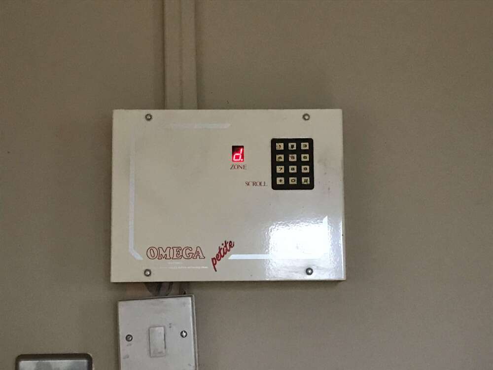

FakeIt5362 Posted February 21, 2021 Posted February 21, 2021 Hi all, I have an Omega Petite system (which I think was made by Castle Care Tech) and I know very little about alarms. I was wondering if someone could tell me how old it is? Also, whenever there's a power cut, the control panel shuts down and the alarm itself proceeds to go off until the power comes back on (people before us didn't think to put a twenty minute maximum on it) and when it does, the panel bleeps endlessly until the code is put in. I was hoping someone would be able to tell me a way to shut the noise off when there is no power to the control panel. Also, any other information would be gratefully received (even if it is random trivia)! Quote

james.wilson Posted February 21, 2021 Posted February 21, 2021 I meant it shouldn't do it, it's broken somewhere. Also due to age it doesn't have a timer in the external bell. The petite is a solid panel unless you have a 5.can you post a picture of the panel to confirm? Quote securitywarehouse Security Supplies from Security Warehouse Trade Members please contact us for your TSI vetted trade discount.
FakeIt5362 Posted February 22, 2021 Author Posted February 22, 2021 12 hours ago, james.wilson said: can you post a picture of the panel to confirm? Yeah of course. Where could the issue in the system be? Quote
al-yeti Posted February 22, 2021 Posted February 22, 2021 2 hours ago, FakeIt5362 said: Yeah of course. Where could the issue in the system be? Battery , hello ? Dude ? Yo? Quote
james.wilson Posted February 22, 2021 Posted February 22, 2021 Yes that's definetly a petite. It needs a service for a start Quote securitywarehouse Security Supplies from Security Warehouse Trade Members please contact us for your TSI vetted trade discount.
