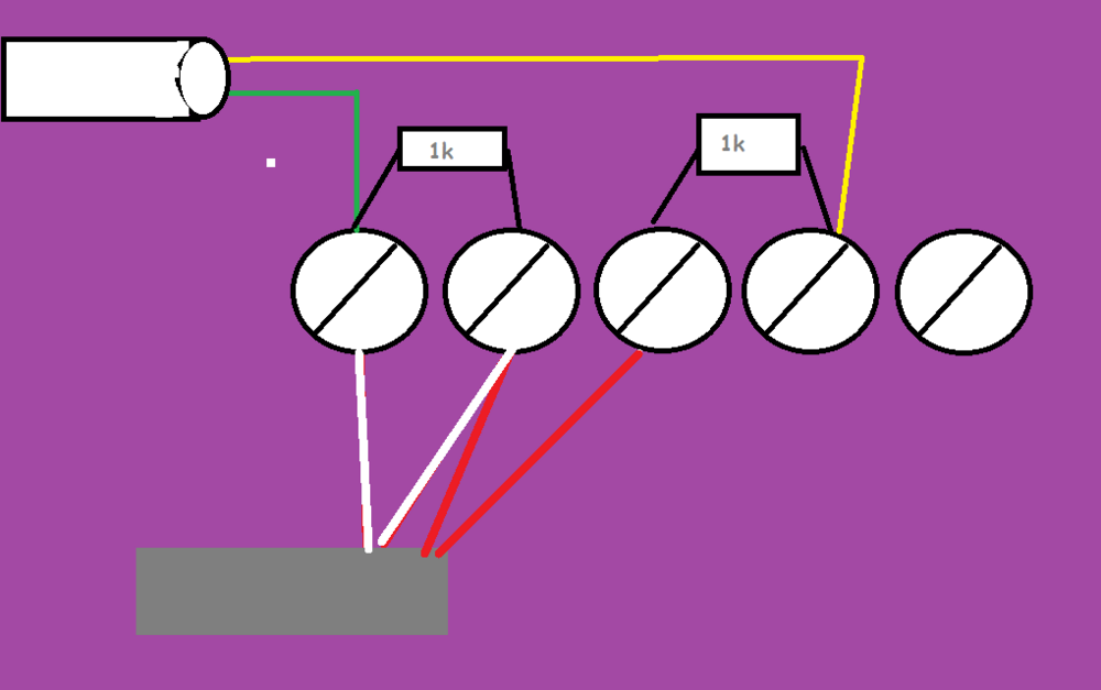

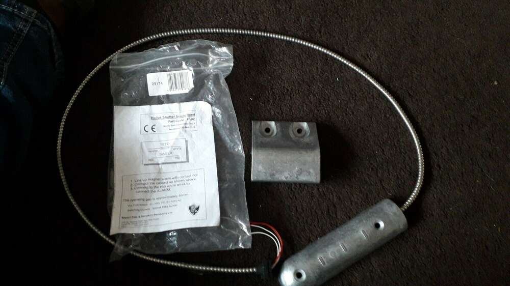

I want to add this contact to my garage door but I am not 100% sure about the wiring
It has,
2 white wires - reed switch
2 red wires - tamper
I know how to wire the white wires via EOL, but do I need to use the tamper wires as well, or is it not necessary ?

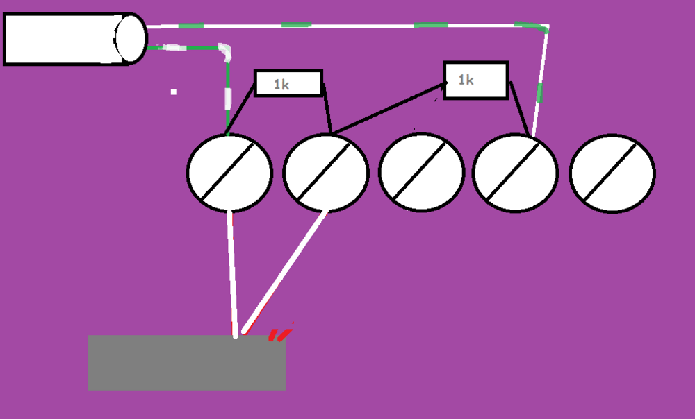

I was thinking
1k across the white wires
Zone common in to white wire
other white wire to red
other red to zone return with 1k
Thanks for reading, hope it makes sense

So you need the tamper proof box and the grommet should fit on it aswell and do as Mr H says or he send the boys round
Thank you MrHappy, thats how I thought
Just so I have this right in my head.
If I only used the white wires and someone cut the metal cable, it would cause a open circuit.
Using the red as well, it will cause a tamper ?
Keef
Yes sir ;-)
cutting the sleeve when the system is unset, will do nowt
cutting the sleeve well the system is armed will produce an alarm
Short answer is yes.
Bear in mind Mr H's helpful diagram doesn't include the JB tamper which would go in series, much like the red pair does.
Something like a J81 or I prefer JB707 would be suitable for connections.
