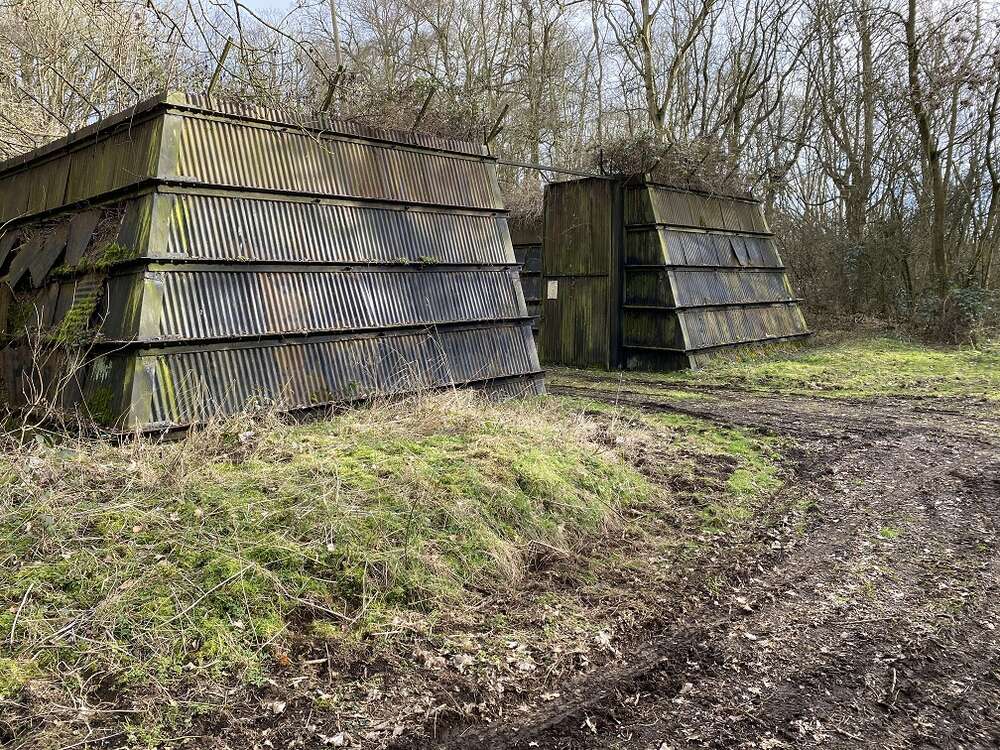

Mark Priest Posted March 8, 2021 Author Posted March 8, 2021 The way the electrics work on site we wouldn't be able do power over ethernet. Each gate is in it's own compound and each has its own supply. As for using the wireless RF gear. The compounds are in the middle of a densely wooded area and the only way to get a signal between the three compounds is by using a dedicated directional antena. A standard texecom for example contact just wouldn't reach. This might give you an idea of one of the compounds (think jurassic park! ) Quote
