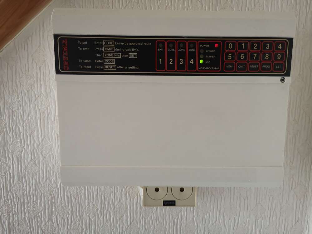

We've got an Opima alarm system on our house which was probably installed 25+ years ago and we're going to replace is for something a bit newer. It actually still works well so I've got some questions about the process for safely removing it. I've got the instruction book which shows the customer code but not the engineer code unfortuantely so I'm trying to work out how to remove it with minimal noise.
As far as I can tell, the process will be -
  1. Isolate power to the main control panel (it's wired alongside the upstairs lighting circuit). The 12v battery inside does still operate the panel when isolated. I had it turned off all last Sunday while decorating and it stayed alight for about 8 hours.

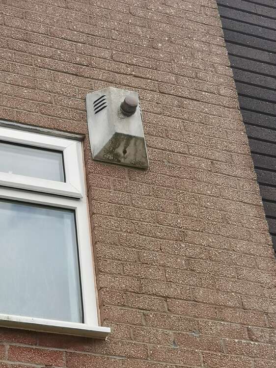

  2. Put my ear defenders on, get on a ladder and carefully take the lid off the bell box. I assume this will trigger the tamper (if there is one) so my wife can input the code on the panel to silence. I don't know if there is a battery in the bell box. It's not that accessible and if there is, I question if it still works.
  3. Disconnect the battery in the bell box (if there is one) and carefully remove the box from the wall. There is a cable running to it which I can cut with insulated side cutters. I assume that as the main power is off, it'll just be 12v.
  4. As the bell box has a strobe, be really careful around this as I know the voltages they carry can be quite 'reasonable'.
  5. Once I've removed the bell box and filled in the holes in the wall etc. the internal panel can be dealt with. Remove the cover, disconnect the battery and disconnect all the cables.
  6. Wired sensors will no longer work so they can be removed now also.
When I lay it out, it doesn't seem that difficult but I just wanted to check if there is anything I'm missing before I proceed. Any help would be greatly appreciated. Pictures of control panel and (terrible!) bell box here for reference -

More or less correct well done. If your replacing the system completely I would suggest you go for hard wired as the wiring is all in place. If you need to add additional detection but have no way of wiring to the new locations then go for a hybrid panel so that you still make use of the hard wire. Wireless systems are fantastic very reliable compared to what they used to be, but there is no point in adding battery powered detection if you have cables run already, your just adding another thing that may go wrong, the batteries will always run out at the most inconvenient time.

I would keep the wires where possible or even install some new cables, I'd at least want to keep the bell wired myself.
