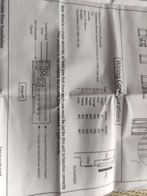

Macca80 Posted March 22, 2021 Author Posted March 22, 2021 On 17/03/2021 at 18:33, sixwheeledbeast said: Read instructions carefully cut the wrong links and you'll likely need another Hi, I've recieved the SC570 contacts today. Am I right in thinking that I need to remove both Red B links? Thanks Quote
sixwheeledbeast Posted March 22, 2021 Posted March 22, 2021 If that's what colours the instructions say? I haven't got one to hand, you would normally only cut one coloured loop from each row for one device IIRC. As al says if you are careful and cut at the top of the loop you could solder the link back closed again, if you get the wrong link. NC is a spare terminal (no connection) Quote
Macca80 Posted March 23, 2021 Author Posted March 23, 2021 12 hours ago, sixwheeledbeast said: If that's what colours the instructions say? I haven't got one to hand, you would normally only cut one coloured loop from each row for one device IIRC. As al says if you are careful and cut at the top of the loop you could solder the link back closed again, if you get the wrong link. NC is a spare terminal (no connection) I've attached the image from the manual. 4k7 and 2k2 both seem to be a red link as I'm understanding it. Quote
sixwheeledbeast Posted March 23, 2021 Posted March 23, 2021 Texe would be type B red then, for a single door yes. 1 Quote
Macca80 Posted March 23, 2021 Author Posted March 23, 2021 47 minutes ago, sixwheeledbeast said: Texe would be type B red then, for a single door yes. Is it both Reds that need cut? One for the switch and one for the tamper? Quote
Macca80 Posted March 23, 2021 Author Posted March 23, 2021 2 hours ago, Macca80 said: Is it both Reds that need cut? One for the switch and one for the tamper? All sorted and working thanks again SWB Quote
