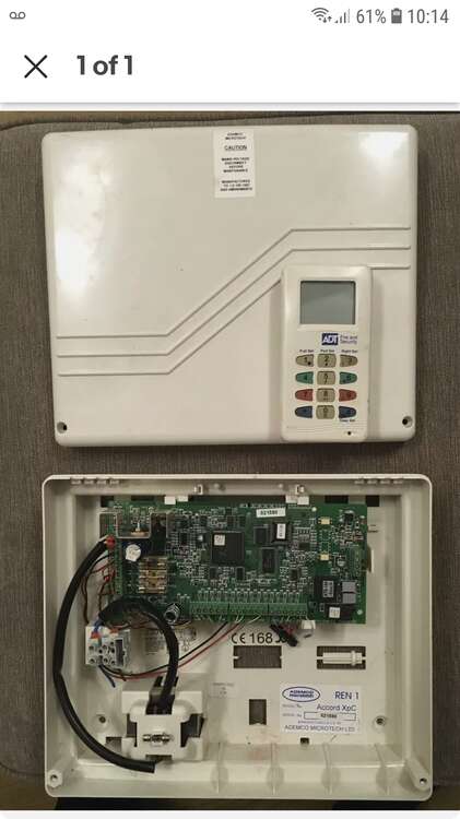

Honda3 Posted June 20, 2021 Author Posted June 20, 2021 On 20/06/2021 at 11:00, james.wilson said: You need to disconnect something or run it on its own fuse to diagnose which bit of kit is blowing the fuse Expand Am i being thick. I thought it would be the keypad because that keeps loosing power and its the aux fuse that blows Quote
james.wilson Posted June 20, 2021 Posted June 20, 2021 if that fuse is only feeding the keypad then yes. But id suspect its also feeding other things. It will be one of those devices. Id go with device rather than cable but as mr h says it could be a staple, nail etc penetrating the cable somewhere 1 Quote securitywarehouse Security Supplies from Security Warehouse Trade Members please contact us for your TSI vetted trade discount.
Honda1 Posted December 12, 2021 Posted December 12, 2021 On 20/06/2021 at 19:34, james.wilson said: if that fuse is only feeding the keypad then yes. But id suspect its also feeding other things. It will be one of those devices. Id go with device rather than cable but as mr h says it could be a staple, nail etc penetrating the cable somewhere Expand Hi everyone long time.but i found the staple through a wire on the stairs. Ive fixed this issue and fuse has not blown since. Can i change this keypad for a newer slightly updated one?thanks Quote
Honda1 Posted December 12, 2021 Posted December 12, 2021 Had to make new account couldn't reset password. Hence new user name. Sorry. Just read through old messages. If i cant update keypad then please recommend a new panel and keypad i can swap with without changing sensors. Thanks Quote
PeterJames Posted December 12, 2021 Posted December 12, 2021 On 12/12/2021 at 04:39, Honda1 said: Can i change this keypad for a newer slightly updated one?thanks Expand The panel hasnt been made over 10 years and that was the most recent keypad they madefor that panel, so sadly the only way to update it is to replace the panel and keypad. Quote
sixwheeledbeast Posted December 12, 2021 Posted December 12, 2021 If DIY replacement anything your capable of fitting and then programming, lots of stuff doesn't come with an install manual any more. Consider the time it will take to work all this out over getting someone in that could have it fitted within 4 hours all being well. Quote
Honda1 Posted December 13, 2021 Posted December 13, 2021 On 12/12/2021 at 11:15, PeterJames said: The panel hasnt been made over 10 years and that was the most recent keypad they madefor that panel, so sadly the only way to update it is to replace the panel and keypad. Expand Please recommend a good one thanks Quote
al-yeti Posted December 13, 2021 Posted December 13, 2021 On 13/12/2021 at 11:16, Honda1 said: Please recommend a good one thanks Expand You may aswell fit a Honeywell flex 50 and go with selfmon if this is all DIY , however you may need help with programming Quote
Honda1 Posted December 13, 2021 Posted December 13, 2021 Is it possible to replace the panel and keypad only and have smart connection so when im out can monitor it. Thanks Quote
al-yeti Posted December 13, 2021 Posted December 13, 2021 On 13/12/2021 at 11:48, Honda1 said: Is it possible to replace the panel and keypad only and have smart connection so when im out can monitor it. Thanks Expand Yes Quote
