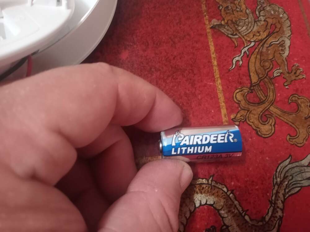

MrHappy Posted July 23, 2022 Posted July 23, 2022 54 minutes ago, james.wilson said: Ive had them leak and destroy terminals as well as just not lasting. Only use duracell or panasonic now Cr123's I had number of panasonic (red & gold) have very short life's of weeks or months, Out of thousands - Camelion couple of weepy ones in the packet, the only failure in the field was a risco keypad melting ! Hundreds of Rapthor no issues, liked the packaging best ! I say the best quality lithium's batteries are GP, However I suspect the best & worst could well be the same stuff made in the same factory ? Quote Mr Veritas God
